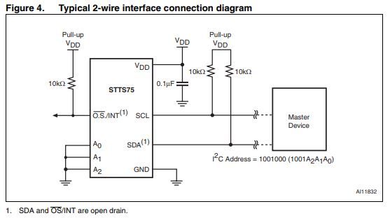

I'm happy to share my schematic. It's actually the same as Fig. 4 in the datasheet under Sec. 2.1 with the exception of /O.S (pin 3).
Per the datasheet if the thermostat capabilities are not in use this pin should be left floating. I'm not worried about that feature right now so I have left it floating. I'm using 10K pullup resistors on the SDA and SCL lines and a 1.0 μF capacitor between VDD and GND rails of my breadboard. I can draw up a proper schematic if you'd like.

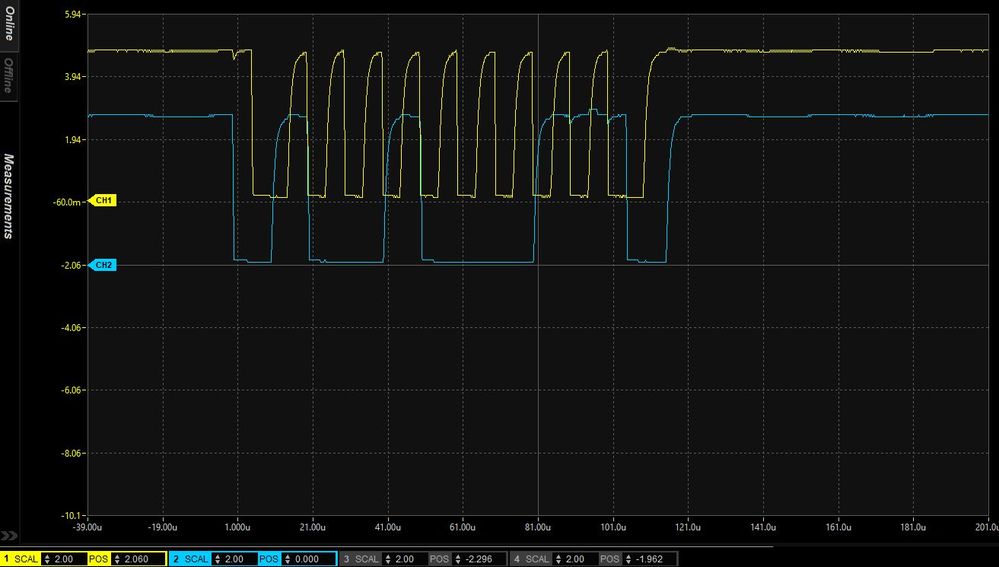

Here's what I'm seeing from the scope. First, the read action. Using this code:
#include <Wire.h>
void setup() {
// put your setup code here, to run once:
Wire.begin();
void loop() {
// put your main code here, to run repeatedly:
Wire.requestFrom(0x48, 2);
delay(5000);
I would expect 2 bytes of data from the preset register (per the datasheet this should be register 0). You can see per the screenshot what is happening is START, ADDR, then no ACK and a RESET.

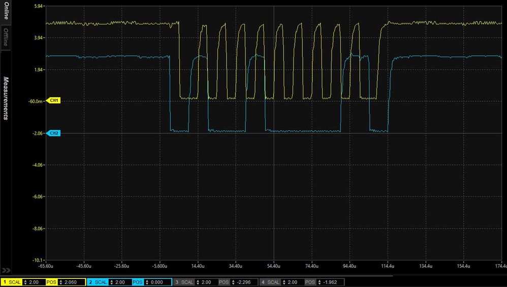

So, I thought maybe I should write the register first. Using this code:
#include <Wire.h>
void setup() {
Wire.begin();
void loop() {
Wire.beginTransmission(0x48);
Wire.write(0);
Wire.endTransmission();
delay(5000);
I am attempting to write but the same issue occurs - START, ADDR, then no ACK and a RESET.

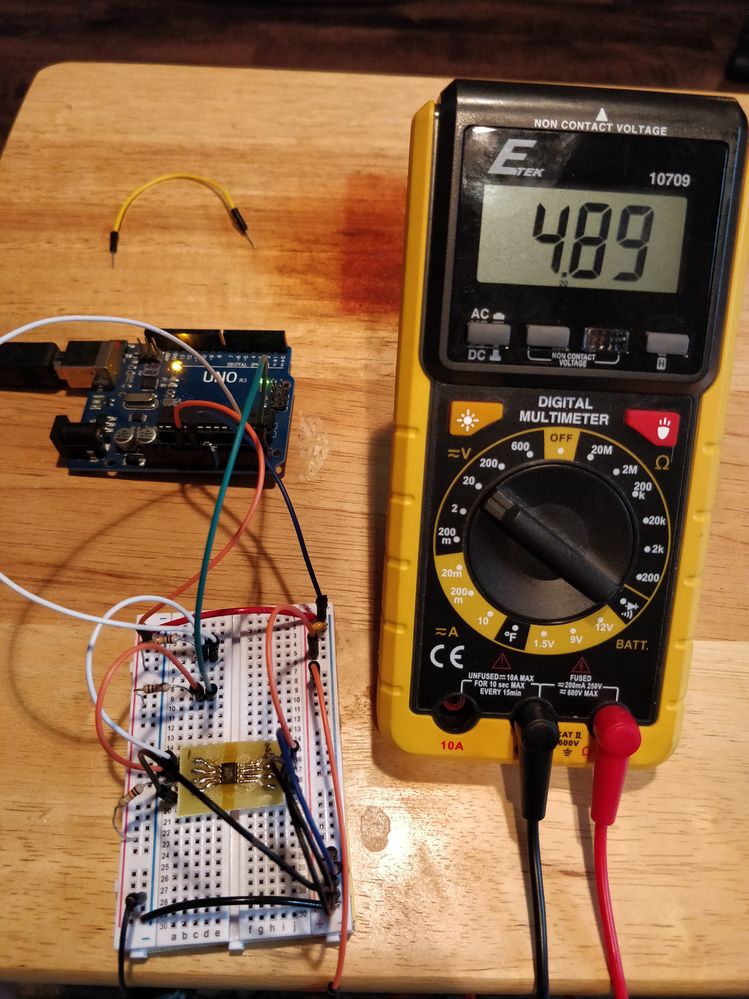

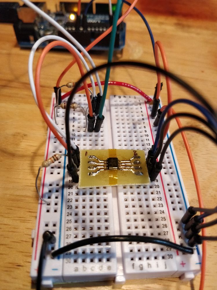

Testing + and - rails on breadboard:
Close up of the breadboard and sensor: These images show a 10K to VDD on the /O.S. (pin 3). I have tried with and without the pull-up resistor.
‎2018-11-28 5:10 AM
I don't see any obvious mistake, but what I don't like are the rising edges of the SDA and SCK.
Could you please decrease the pull-ups to 3k3 or even less and try it?

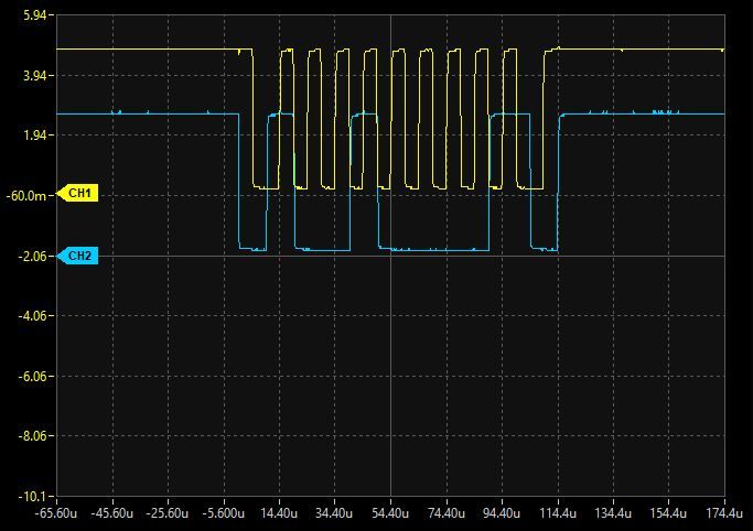

‎2018-11-28 6:22 AM
As requested, 1k5:
It certainly looks cleaner but no ACK. :(
