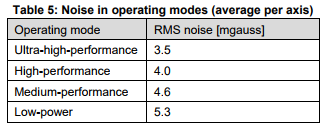

2- In addition I want to know if there is any difference in resolution of operating modes? For example if I select the Low power mode in LIS3mdl with +-2Gauss range, how would be the resolution in other modes?

We do not share number of samples used for averaging, but we provide information about the RMS noise in different modes.
The resolution is the same for all modes.
