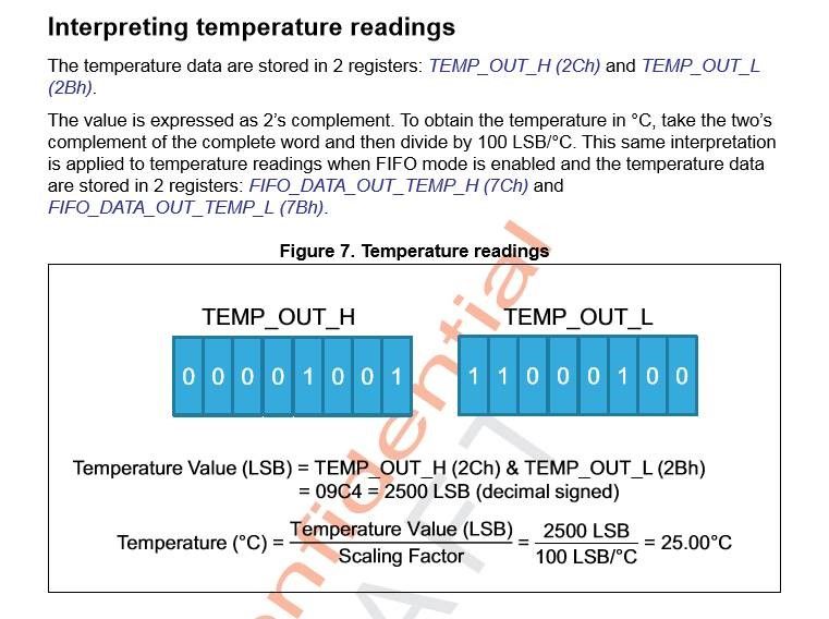

I may be exceptionally dumb, but I can't find in the STTS22H DS, how can the measured temperature be determined from the values read from the temperature registers.
What am I missing?

    Hi @Community member​ , you can also refer to the online available C drivers (github link) for the conversion between LSB (concatenate TEMP_H_OUT and TEMP_L_OUT) and °C in STTS22H
    float_t stts22h_from_lsb_to_celsius(int16_t lsb)
     return ((float_t)lsb /100.0f);

    Okay; but isn't the DS the primary source which ought to contain this information?
    And, once we are at it, what's exactly the meaning of BDU bit in CTRL register?
    Frank, @KnarfB​ ,
    Yes, that DS - can you see in there how to interpret the values read out of the TEMP_L_OUT/TEMP_H_OUT registers?

    Hi @Community member​ , technically you are not wrong... I'll report it to the product champion. Thank you for your note. Regards

    Hi Jan, after an internal check we should be able to add in the next datasheet revision a paragraph explaining in a clearer way the temperature readings interpretation, similar to the below-shown LPS22HH's one:
