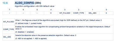

Best answer by Federica Bossi
Hi @mobaid ,
Can you try to enable the bit SEL_ABS of register ALGO_CONFIG (28h) and let me know if this solves?

Hi @mobaid ,
mobaidAuthor
September 10, 2024
Hi @Federica Bossi  ,
the issue is solved , thank you so much .

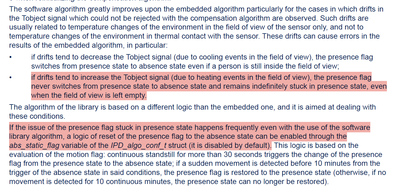

but ,what is the relation between presence flag stuck state when the sensor is exposed to cold object  and sellecting the absolute value in the presence detection algorithm ?

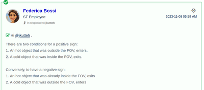

Visitor II
September 18, 2024
Hello, according to this conversation, your problem was that 'A cold object inside of the FOV exits'. But I don't understand why ..
Moreover, why selecting absolute value of TPRESENCE would solve detection issues ?

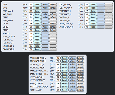

I am using the evaluation kit from ST :

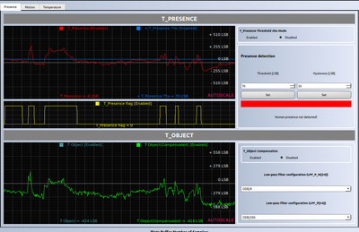

It’s been super useful since it can trace TOBJECT, TPRESENCE, and other values in real-time. It really helps to understand why sometimes we get detected and sometimes not, like in this situation :
Based on the configuration I’ve been using, here’s a capture of the registers:
