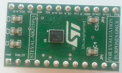

Hi, ST eval adapter for the LSM9DS1 is named STEVAL-MKI159V1, where did you found the STEVAL-MKI159V3 one?
https://www.st.com/en/evaluation-tools/steval-mki159v1.html
Can you check if the adapter you have looks like this one?
0693W00000D27wIQAR.jpgAnd after how many readings does the device stop working?

1.oh, yes. I misspelled V1 as V3. that's right.
The device does not stop and continues to receive the same value as the first one.
For example, if you receive -1 at the beginning, it continues to return only the value of -1.
