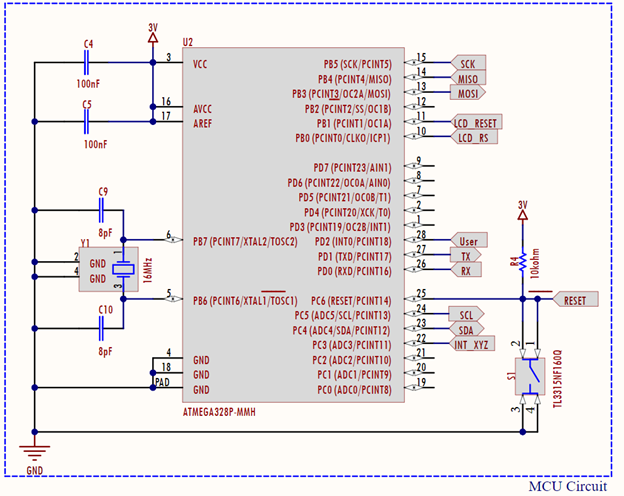

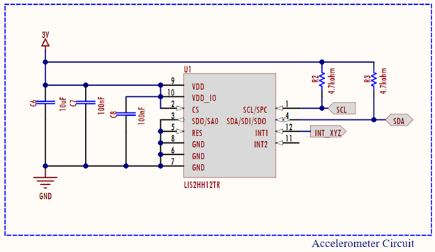

0693W00000D2NHfQAN.png0693W00000D2NHuQAN.pngWe have been using the LIS2HH12 accelerometer and it will work on a fresh board for about a day or so and then stop working. Below is some stripped down code from this library:

An oled display is being used as a serial monitor for this. Attached also are snippets from the schematic:

Hi, the fact that your application works for a while (an entire day, continuously?) and then stops, makes me suspect that is is not a configuration issue, but it is related to something else. Maybe a buffer filling and then getting overflow? Or what if you your application or the device itself loose the supply connection for a while? It would cause the LIS2HH12 to stop working since the volatile register would go back to 00h value. When you restart the application, does the LIS2HH12  functionality recover?
