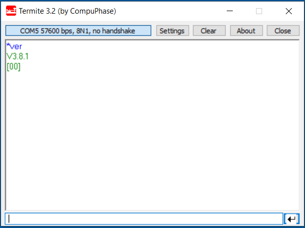

‎2021-07-27 2:26 AM
Hi @FCook.1​ ,
But does this procedure work on Windows 10? You could try with a direct access to the VCOM, such as with Termite.
You can write the *ver command and check the different available active VCOM ports if the board doesn't respond.
I also noticed you have posted another question about the adapter, I saw Peter answered and I confirm he is correct. No need to take into account for pins different from the IIS3DWB datasheet ones.
-Eleon
