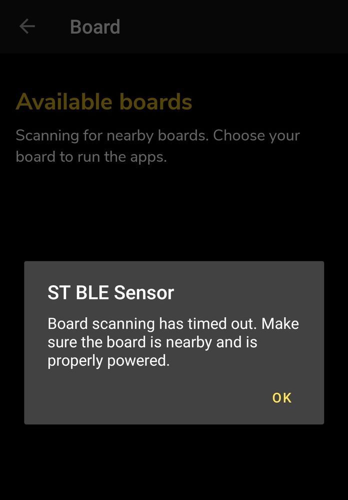

I've the STEVAL-STWINKT1B,
I've flashed ,
\STMicro\SW\en.fp-sns-datalog1\STM32CubeFunctionPack_DATALOG1_V1.1.0\Projects\STM32L4R9ZI-STWIN\Applications\HSDatalog\Binary/HSDatalog.bin
But I do not able to read the sensor data.
I do not access the environment and other params.
in ST BLE, New application>Vibration monitor> Training>>Play result in Boards scanning running out.

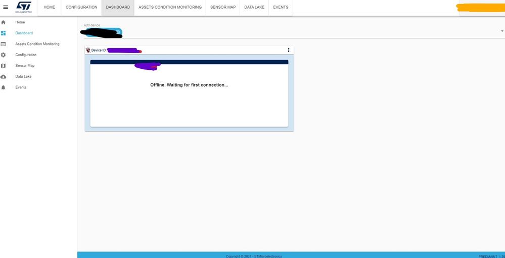

I've added the AWS security key and private key in Cloud menu of the BLE app. it notifies AWS Active still in the dashboard it says device unconnected.
Please find the images attached below

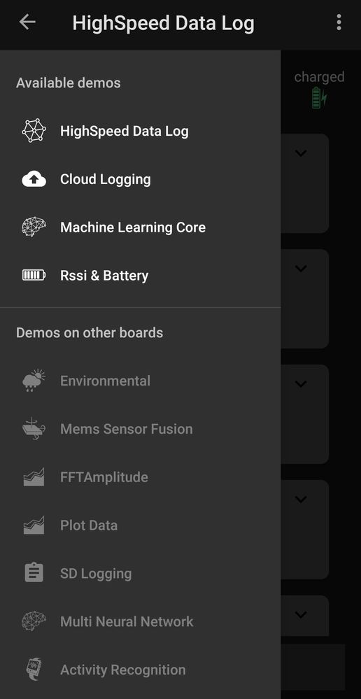

Are you trying to use the ST BLE Sensor app on a smartphone / device with the BLE connectivity enabled?
I'm checking internally with our experts to figure out the issue.
You might try with the FP-IND-PREDMNT1 function pack, that enables data to be send on the Cloud. The HSDatalog example saved the data on the SD card or sends them via USB to the logging application.
Note also that in the HSDatalog the USB is not recognized as a serial port.

However, I am not able to succeed with the Dashboard of predictive maintenance with STWINKIT1B(No wifi only Bluetooth). I do add the AWS link and key and it returns

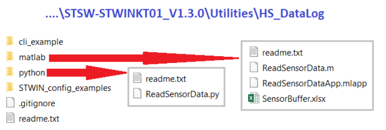

Ps: the files .dat are raw file (like a binary file) so for see its contents is necessary elaborate it’s, also taking into account the .JSON file which internally has the acquisition sampling rate. Inside the Utilities folder, a MATLAB and a Python script are available to automatically read and plot the data saved by the application.

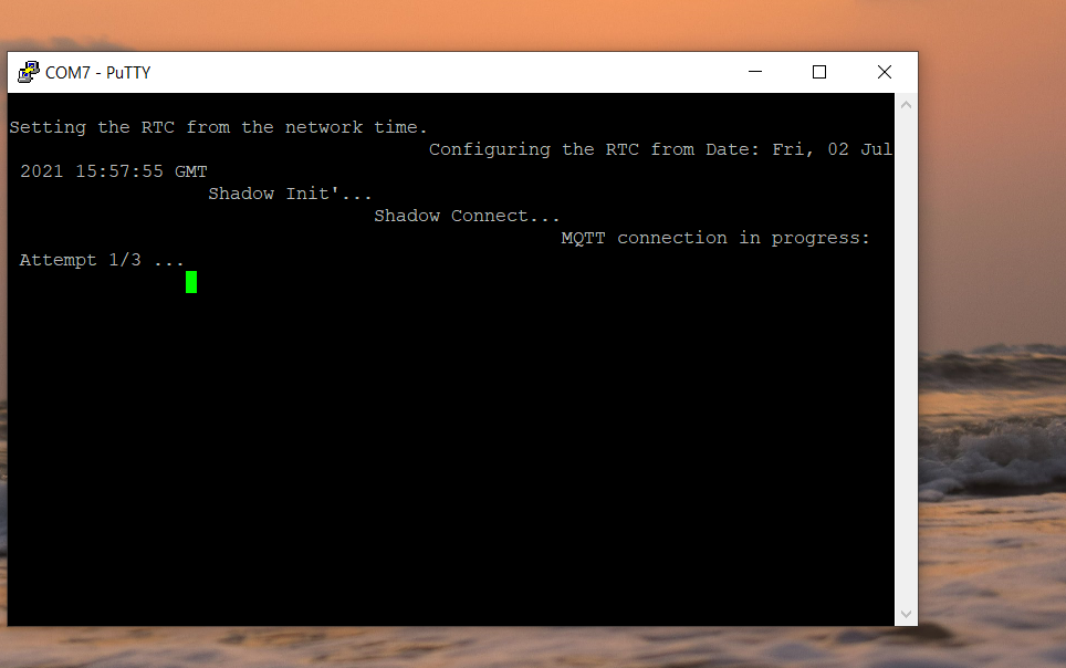

I've got the wifi expansion module but it stucks at attempt after all the keys enter

I get this error:
Configuring the RTC from Date: Sat, 03 Jul 2021 04:03:28 GMT
ERROR: aws_connect_to_cloud L#97 The length of the device name stored in the iot user configuration is larger than the AWS client MAX_SIZE_OF_THING_NAME.
AWS IoT SDK Version 3.0.1-
Shadow Register Delta ErrorCLOUD_WIFI_CONNECTION_ERROR
*** Cloud connectivity demonstration ***

2021-07-06 7:21 AM
Hi @LK N.1 ,
after checking with our experts, the focus is on this error:
This means that probably the name you have generated is too long, and should be shorter than the constant in the macro defined in the aws_iot_config.h file (#define MAX_SIZE_OF_THING_NAME 21): it is however suggested to shorten the name and not to modify the macro. This because the thing(device) name is used in almost all the messages exchanged, so it could lead to a non-negligible increase of memory use.
For completeness, there should be no need to create an account in AWS cloud, since it is free for few devices. You can create ca new device on the dashboard from scratch.
Let me know if this can solve your issue.
-Eleon
2021-07-06 11:37 PM
Hi @Eleon BORLINI ,
Thanks for your support.
It's working fine.
