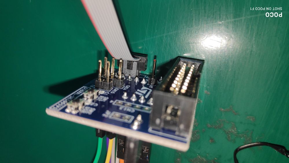

i am having a STEVAL-IDP005V1, STEVAL-UKI001V1, 10-pin-IDP005V1 Cable, M12female connector.
i am referring this document ( https://www.st.com/resource/en/product_presentation/steval-bfa001v1b_quick_start_guide.pdf )
i am not able to connect the board to my PC.  please anyone suggest me to do the analysis of accelerometer

Are you using the swd connector?
Make sure you are powering the device 18V or higher as per the requirement
The swd connector at the steval , how did you connect to it ? whats the orientation?

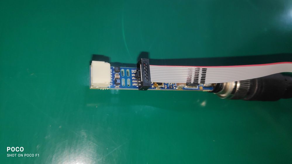

Yes, i am using the SWD Connector.
Yes, i applied the input voltage is 18.5 V. (brown Positive and blue negative)
Please refer the Picture.
IMG_20250506_122201.jpgIMG_20250506_122232_1.jpgIMG_20250506_122250.jpgIMG_20250506_122255.jpg
I don’t recall the exact orientation of the connector on the st board but you can try connecting the swd connector on stm32 in the reverse direction (I had similar issue and I figured out that the connector needs to be connected in reverse direction and then it worked)

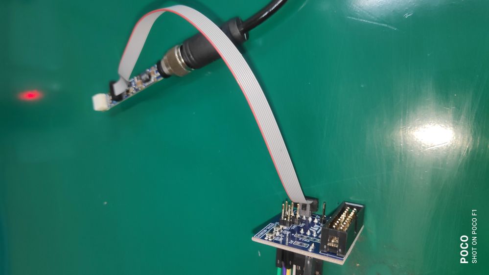

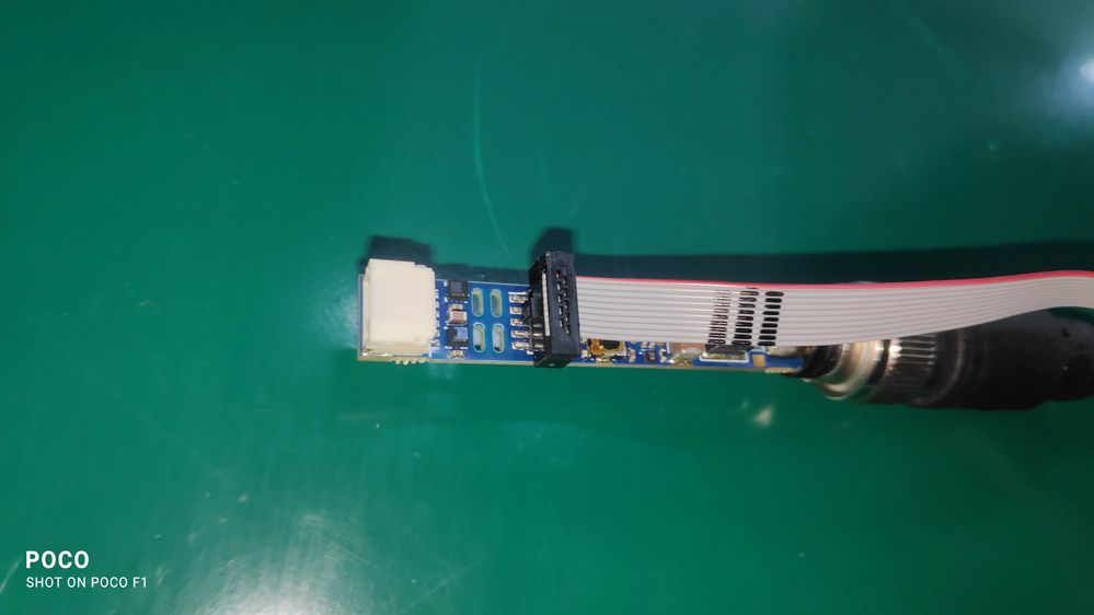

IMG_20250506_140126.jpgIMG_20250506_140130.jpgIMG_20250506_140139_1.jpgIMG_20250506_140144.jpg
If you have any Documentation, please share to me.
i attached the clear photo.

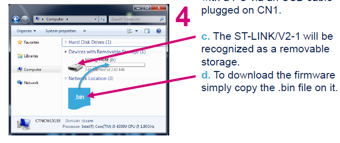

This 4 Step can not able to do . i am not getting the .bin files .
Can you tell me if you can use Stm32Cubeprogrammer software and connect to the device?
The binary file can either be compiled and generated or it is available in the BSP example folder
when everything is connected as it should the led on the board (third image) should light up
if it doesn’t the steval board isn’t powered by 18v (The cable I received was faulty/ not wired correctly this might be another reason)
Check on the steval board VDD /GND is reading 18v using a multimeter to confirm its not a bad cable
