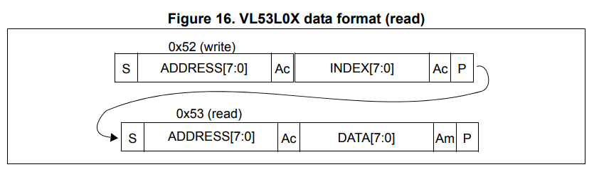

2019-04-04 2:19 PM
Hi, your VL53L0X_read_multi is wrong. Take a look on datasheet:
You should send an address WRITE followed by command (index) and stop P transmission. Then start S transmission reading the data.
I've got something like this:

2019-04-08 11:53 AM
Here is an app note that might help. Take the code from the doc and insert it to the top of your main. It will test the endian-ness of your implementation.
2019-05-26 3:44 PM
Below is a working version.
It passes the above verification code ftom ST and I get measurement data from the sensor!
(original code it taken from the net - lost the reference to the original author - sorry!)
But, there was a bug in the original version wrt to the VL53L0X_write_multi - it did not work!
Theo's note - put me onto the right track.
