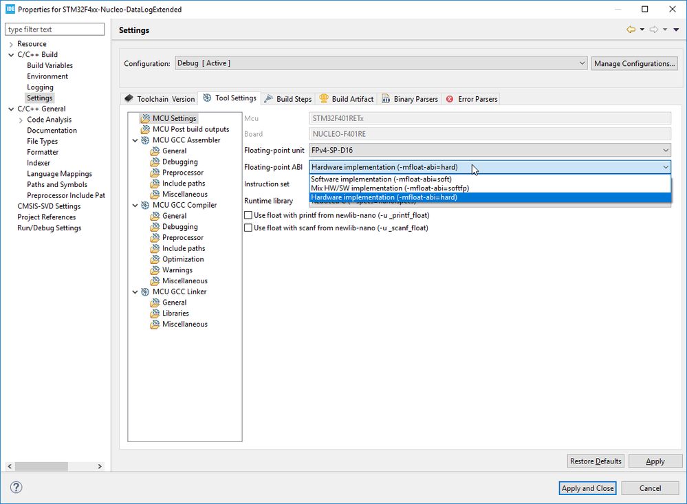

Is the source code for ST.COM's X-CUBE-MEMS1available? I am using an STM32L412. And when I try to include the STM32 pre-compiled library into my project I get errors. I am thinking the processor I am using is not compatible with the libraries. So I'd like to try using the source code instead.
-thanks

Here are the 2 lines of errors I see after adding the X-CUBE-MEMS1 MC and EC libraries and the associated header files...
c:/program files (x86)/atollic/truestudio for stm32 9.3.0/armtools/bin/../lib/gcc/arm-atollic-eabi/6.3.1/../../../../arm-atollic-eabi/bin/ld.exe: error: LSM9DS1 Driver.elf uses VFP register arguments, ../Middlewares/STM32_Motion_Library/Lib\MotionEC_CM4F_wc32_ot.a(motion_ec.o) does not
c:/program files (x86)/atollic/truestudio for stm32 9.3.0/armtools/bin/../lib/gcc/arm-atollic-eabi/6.3.1/../../../../arm-atollic-eabi/bin/ld.exe: failed to merge target specific data of file ../Middlewares/STM32_Motion_Library/Lib\MotionEC_CM4F_wc32_ot.a(motion_ec.o)
Miroslav BATEK
Please check the project settings in C Compiler - target - Floating point.
These should be settings something like "Mixed ..." not Hardware Implementation.
The libraries are compiled with -mfloat-abi=softfp option .

So, the error is not truncated. I believe it is saying my code is setup to use VFP registers and the MotionEC code (library) is not. I'm assuming VFP controls the way the ARM registers are used. However, I am not sure what I am looking for in the code. As there are many defines with VFP in the define names (for example: "_TARGET_FPU_VFP", "_ARM_PCS_VFP", "__VFP_FP__", ect).
Miroslav BATEK
Go to project properties and try to find the settings there,
I don't have Attolic TrueStudio but in STM32CubeIDE it looks like in the attached screenshot.

Digging further, (according to this stack exchange question / answer: https://stackoverflow.com/questions/9753749/arm-compilation-error-vfp-registered-used-by-executable-not-object-file) this may be a "hard-float" verses "soft-float" problem.
Rstua.1
Senior
Trying something: Under Properties=>C/C++ Build=>Settings=>Tool Settings=>C Compiler=>Target=>Floating point change from "Hardware Implementation" to "Mix HW/SW implementation". Also did the same under Linker (Under Properties=>C/C++ Build=>Settings=>Tool Settings=>C Linker=>Target=>Floating point change from "Hardware Implementation" to "Mix HW/SW implementation"). Now the project compiles! But I am not sure if the code is working as expected yet.
