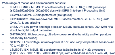

I just started with the ASM330LHHX DIL24 module for the X-NUCLEO Boards, the module is listed as compatible with the IKS4A1 (sensors below):
I have read some documents related to the procedure to make it work but it's an "old" document (see below), I look for general advice:
  • Once the module is inserted do I need to configure any jumpers in the XNUCLEO board?
  • If there is no need to modify jumper configuration on the board, does that mean that all configuration is done via software, correct?
  • Once I gain access to the ASM330, the rest of the sensors onboard the IKS4A1 will be available? all of them + the ASM330?
> If you have a tip or advice related to the configuration to enable the ASM3330 feel free to share it.
