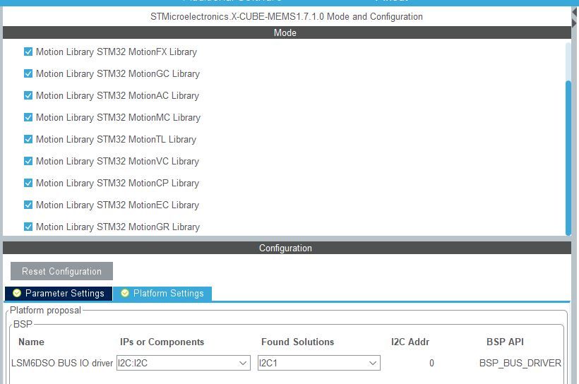

I can select MEMS device(s) and required algorithm(s) see attached image.
Than I can generate required code
Drivers\BSP\Components low level MEMS drivers
Middlewares\ST\STM32_MotionAC_Library actual algorithms
Questions: where should we go from here? Does any parameters needs to be configure ie MEMS sensor I2C address?
Which APIs should be called and when? For example if we call algorithmInit(...) function, does this function will initialize MEMS?
Does user needs concomitantly read sensor and send data to the algorithm? or algorithm handles all readings and all user has to do
just to read algorithm result function?

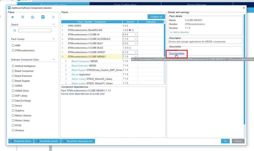

Hi @IB.1​ , you can find some tutorial documentation in CubeMX, although not on video support. I'm referring to the “Getting started with the STMicroelectronics X-CUBE-MEMS1�? document available and accessible directly from the STM32CubeIDE/STMCubeMX. Please see the picture below. Regards
