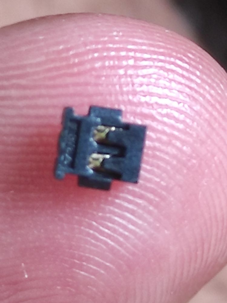

I would also like to know the model number of sensortile box battery connector, since the wire has ripped off the connector due to repeated handling.

I'm very sorry that your battery connector broke, the part number is PS-78172-0002, but I would suggest to resolder it to the wires.
