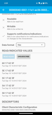

Hello, I'm having trouble interacting with the SensorTile Box Pro through the BlueST protocol.
I've used the ST BLE sensor app to set the device to stream compass data, I used the included example and did not change anything. In the app, I can receive compass data without a problem with its included visualiser. I then used the Lightblue app to receive the same data, and it worked without a problem. I used the BlueST datasheet to figure out which characteristic held the compass data, and subscribing to receive notifications worked immediately.

It is not a problem of the sensortile PRO BLE protocol.
In fact, with other apps, even not the official one, the notifications work and show up.
Try debugging the bluetooth library that uses esp32.
