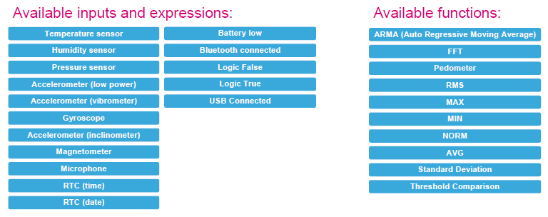

Why should one need something more, if a lot of everyday-life applications are already available by default as examples? Different reasons, indeed:
  • Power optimization: Individual sensors can be activated or shut down to enable only the required sensor set
  • Hard-iron compensation and offset cancelling: SensorTile.box can be individually calibrated after final assembly & positioning
  • Pattern recognition, accuracy: Neural network and dedicated sensor fusion options can be activated
Expert mode allows user to create his own application / algorithm by using Expert View in ST BLE Sensor application (here you can find the app source code!). Get an insight on all the available inputs and functions of the Expert mode here below �?�:red_triangle_pointed_down:�?�
