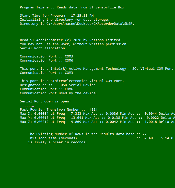

I have the tilebox pro exporting on the USB and picking it up with a new C# program.   See below.
It is reading at 18 cycles per second, I need to adjust the freq output, I thought I had a higher rate.
it is really easy to use, but I have the Android Program setting 75 from pressure and temp and 480 for acceleration and getting 18 time steps per second.  Is this your board's limitation on exporting via the USB cable.

Hi @Smithson ,
The USB data transmission limit for the Sensortile.box PRO is approximately 100 samples per second.
Try creating a flow with a Bluetooth output (instead USB), then plot the accelerometer data in the app, and check that it runs at 100 Hz.
Then switch the output flow to USB and test your system again.

Dear Federica:
Thank you for your response, I appreciate the effort.
I have looked at the matter based on your idea and it helped me find the cause of the error.
I need data that will stand up in court, so being able to explain the data in the simplest possible terms is important.
Your cli_example program works fine.  I like my version, but that is personal preference and the fact that I am matching other data from other accelerometers both ST.COM and no-ST,com, means that we want a standard form of output.

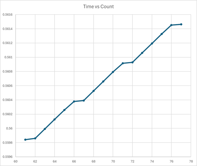

Problem 1, you try and upload all of the different sensors to one csv file using a common time signal.  That is not possible in a applied mathematics sense.  Your sensors can run at different rates and the flow of information  also adds timing errors.
Problem 2 you cram all of this data into a single csv file.  If run the accelerometer at about 1800 Hz, it runs fine using your main program over a USB cable at this speed.  It just saves the dat files.  But the other devices are running at 4 times the 1800 Hz for the gyro and other speeds. So MEMS Studio is trying to cram all of this data into a single time signal.  I now understand how it works, can I say simply it is a very bad idea.

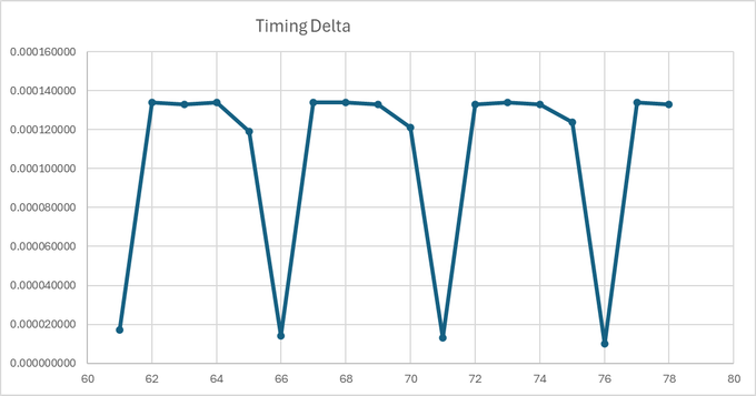

Looking at the time signal from a run this morning of 19.1 seconds.   You have steps that are not a standard distance apart, this is your algorithm adjusting for the varying measurement rates.  A sample output is shown.
If I look at the differential timing, you can see the pattern and it is not what one expects, nor is it explained in your manuals.  This is the timing steps.

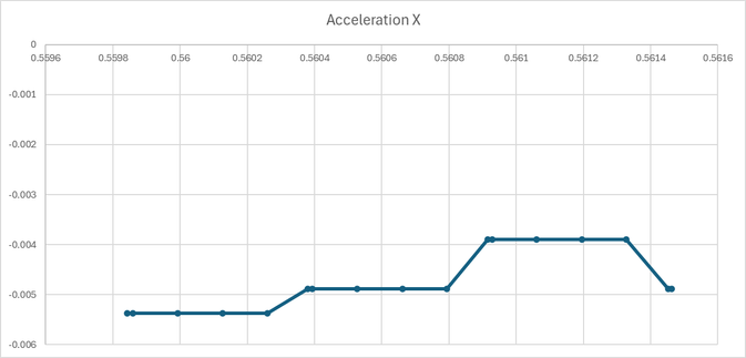

If I look at the acceleration output,  your method has introduced a pseudo flat step and triangular step into the time signal, this will show up in any post FFT analysis of this data.   And it will play with the numerical integration, so beloved of engineers.  You fill up the gyro time steps with the last acceleration data and create a flattish spot. See example.  Like determining volumes from contour data, one has to make a decision, I understand this decision, I think it would be easy to improve.
