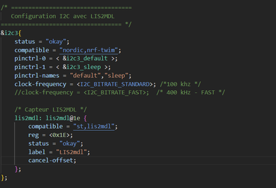

Hello everyone,
I'm working with the LIS2MDL sensor (steval_mki181v1) , i made a connection between it and the nrf5340 and I configured it over I2C with pull-up resistors enabled.
-VDD -- > VDD
-VDDio --> VDD
-CS --> VDD
-PIN I2C  :: SCL to SCL et SDA to SDA
-GND t GND
Current configuration:
  • I2C communication working (i got the chip id 0x40)
  • Block Data Update (BDU) enabled
  • Output Data Rate tested at 10 Hz or50 Hz
  • Offset cancellation enabled
  • Continuous mode enabled
  • I applied the offset XYZ as ::
    int16_t mag_offset[3] = {
    0xF500, /* OFFSET_X_REG */
    0xF800, /* OFFSET_Y_REG */
    0xF400, /* OFFSET_Z_REG */

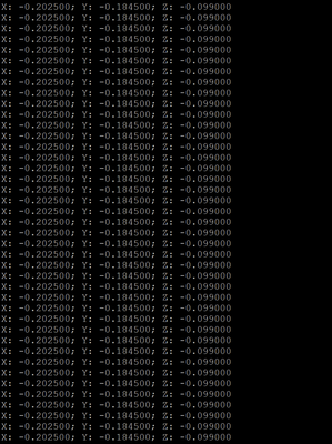

However, I noticed that the values I read from the sensor remain almost always the same and do not update as expected, as shown in the photo below.
Could anyone help me understand what might be causing this issue or guide me on how to troubleshoot it?

A schematic is more useful than a text list of connections.
What pullups did you use?
Have you used an oscilloscope to verify that you have good, clean edges?
See the diagram here for the effects of pullup resistance - from too low to too high ...
@ASREB wrote:
i used the board nrf5340 (nordic board) et le lis2mdl dans le module steval_mki181v1
Have you tried using an ST board, and ST's provided software ?
Obviously, issues with the nRF5340 are beyond the scope of this forum - so would be good to remove that as an "unknown".

Hello Andrew
I don’t think the problem comes from the Zephyr driver, because the driver uses the same logic as the ST driver, especially in this configuration.
https://github.com/STMicroelectronics/STMems_Standard_C_drivers/blob/master/lis2mdl_STdC/examples/lis2mdl_read_data_polling.c
Have you actually tried that example?
You didn't answer about the pullups, or schematic.
