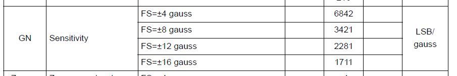

I am using LIS3MDL sensor and I do not understand the sensitivity which its unit is LSB/Gauss.
In x-cube-mems1 library, the following is calculated:
&sharpdefine LIS3MDL_MAG_SENSITIVITY_FOR_FS_4G    0.14 /**< Sensitivity value for 4 gauss full scale [mgauss/LSB] */
&sharpdefine LIS3MDL_MAG_SENSITIVITY_FOR_FS_8G    0.29 /**< Sensitivity value for 8 gauss full scale [mgauss/LSB] */
&sharpdefine LIS3MDL_MAG_SENSITIVITY_FOR_FS_12G    0.43 /**< Sensitivity value for 12 gauss full scale [mgauss/LSB] */
&sharpdefine LIS3MDL_MAG_SENSITIVITY_FOR_FS_16G    0.58 /**< Sensitivity value for 16 gauss full scale [mgauss/LSB] */
and in the datasheet:
My question is how did they calculate the sensitivity in the above code? and also what does LSB/Gauss mean?
Thanks in advance.

Regarding the values in the code mentioned in the cube library:
For +/- 4 gauss, the sensitivity is 6 842 LSB / gauss, meaning 6 842 = 1 gauss, 12 964 = 2 gauss, 19 806 = 3 gauss, etc...
However, one way to interpret the data is to read the raw value and display as miligauss.
If 1 gauss = 6 842, then 1 000 mgauss = 6 842, meaning 1 000 mgauss / 6 842 = 0,146156 mgauss / LSB.
The same applies to the other ranges. It is just a different look at the same data.

There are at least two ways of calculating the output value, if you know that the sensitivity is 6 842 LSB per 1 gauss (=1 000 mgauss) and the sensor gives you output of
–32,768 to 32,7
1)
magnetic_intensity = raw_data / sensitivity
with the following units:
[gauss] = [LSB] / [LSB/gauss]
so sensitivity is represented here as[LSB/gauss]
This relates to the values printed in the datasheet and discussed in the linked discussion.
2)
magnetic_intensity = raw_data * sensitivity
[gauss] = [LSB] * [gauss/LSB]
[gauss/LSB] (which is an inverted value)
The fact whether you count with gauss or miligauss doesn't affect the equation, just the sensitivity coefficients (and/or the result).
This relates to the values in the Cube library.
0.14 < Sensitivity value for 4 gauss full scale [mgauss/LSB] (= 0,000 14 gauss/ LSB)
0.29 < Sensitivity value for 8 gauss full scale [mgauss/LSB] (= 0,000 29 gauss / LSB)
0.43 < Sensitivity value for 12 gauss full scale [mgauss/LSB] (= 0,000 43 gauss / LSB)
0.58 < Sensitivity value for 16 gauss full scale [mgauss/LSB]
(= 0,000 58 gauss / LSB)
ST chose version 2, however, I like version 1 more. Version 1 can be faster and use less resources, moreover, with a higher precision!
