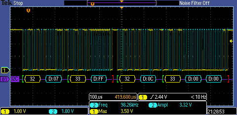

Hi all,
I'm currently not able to read the temperature of my lis2de12.
It always returns zero.
lis2de12_temperature_meas_set(&dev_ctx, LIS2DE12_TEMP_ENABLE);
lis2de12_data_rate_set(&dev_ctx, LIS2DE12_ODR_400Hz );
lis2de12_block_data_update_set(&dev_ctx, PROPERTY_ENABLE);
What could be the issue here?
I'm only reading temp, not X Y Z values yet.
UPDATE:
After playing around reading OUT_TEMP_L (0Ch), OUT_TEMP_H (0Dh) separately, my code now reads twice 0x80.
I think my platform functions are not incrementing the register address?
static int32_t platform_read(void *handle, uint8_t reg, uint8_t *bufp, uint16_t len)
HAL_I2C_Mem_Read(handle, LIS2DE12_I2C_ADD_H, reg, 1, (uint8_t*)bufp, len, 1000);
return 0;
Otherwise I would assume seeing 0x0D in the scope image.

I'm using that driver, it works fine for reading single register, not if you need incremental register address 0x0C to 0x0D
The working depends on what is inside platform_read()
For now I fixed it with, but not ideal:
if(len == 2)
HAL_I2C_Mem_Read(handle, LIS2DE12_I2C_ADD_H, reg, 1, (uint8_t*)bufp, 1, 1500);
reg++;
bufp++;
} else {
HAL_I2C_Mem_Read(handle, LIS2DE12_I2C_ADD_H, reg, 1, (uint8_t*)bufp, len, 1500);
return 0;
Would be nice if HAL_I2C_Mem_Read() had an register increment option

You can look here how to implement the read/write multiple.
You will find this comment: /* Read multiple command */ and how to implement it in I2C communication.
