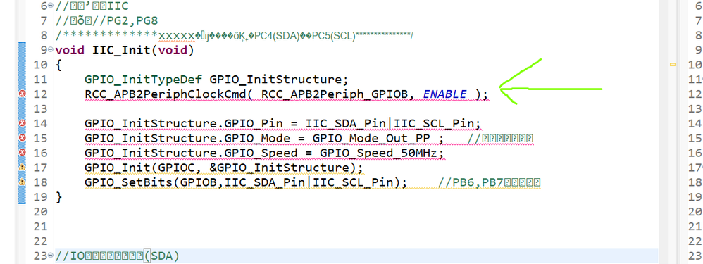

Hi. I'm trying to translate the SHT30 library for stm32l0. But I could not understand and translate the "IIC_Init" part of the code. I didn't understand the init part, I couldn't translate it and it only gives a line there What do you think are the operations it does in this function? I think it doesn't work with i2c because there are parts called SDA_IN() and SDA_OUT(). It sets it as GPIO input and GPIO output. Can you explain what it does in the init part? source code-> https://github.com/thejbte/Example_OS_QuartKTS__STM32
void IIC_Init(void)
GPIO_InitTypeDef GPIO_InitStructure;
RCC_APB2PeriphClockCmd( RCC_APB2Periph_GPIOB, ENABLE );
GPIO_InitStructure.GPIO_Pin = IIC_SDA_Pin|IIC_SCL_Pin;
GPIO_InitStructure.GPIO_Mode = GPIO_Mode_Out_PP ; //�������
GPIO_InitStructure.GPIO_Speed = GPIO_Speed_50MHz;
GPIO_Init(GPIOC, &GPIO_InitStructure);
GPIO_SetBits(GPIOB,IIC_SDA_Pin|IIC_SCL_Pin); //PB6,PB7�����

Well imo you don't need the IIC_Init function above and it would not make sense to configure both pins as outputs and setting them anyways ( IIC_SDA_Pin | IIC_SCL_Pin are ored so both pins will be configured at the same time).
Your SDA_IN and SDA_OUT functions configure the pins seperately so maybe:
void IIC_Init( void )
SDA_IN();
SDA_OUT();
will do the trick ?!
BR, Tom
‎2021-12-24 7:20 AM
It enables the GPIOB clock, then it configures the pins as output push-pull, then it sets those pins high.
CubeMX will generate this part for you if you don't know the syntax.
