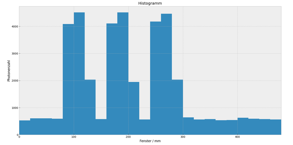

I've checked my histogram data generated by VL53L3CX Sensor and I also have those additinal spikes in my plot (see below), although there are no additonal objects within field of view. The Sensor is fixed in 70cm height and directed towards a white wall in 60cm distance. I assume the calibration data has not been included yet, since actual range report seem to be okay. Where do these two spikes come from?
John E KVAM
I think there is something wrong with your data capture. You are right. One object - like a wall will give you 3 'posts', like you have, but you will not those repeats.
Would you be willing to share some pseudo code?
Each bin is 20cm (more or less) So at 60cm you would expect to see data in the 3rd bin. And adjustments within the 20cm depends on the ratio between the first and second post. So I would have expected to see two bins at almost the same height as you have.
At 70 cm the initial post would be about half that of the second one.
That data almost looks like the combination of multiple collects. Very similar, but slightly different values - what I would expect from multiple collects.

ABesp.1
Alright, I have defined the following array inside my result structure
int32_t histogram[VL53LX_HISTOGRAM_BUFFER_SIZE];
which holds bin data for each VL53LX_MultiRangingData_t
memcpy(result->histogram,
	VL53LXDevDataGet(pdev, LLData).hist_data.bin_data,
	sizeof(result->histogram));
Then I just format it into a string
HAL_StatusTypeDef TransmitHistogramDataRS232(
		UART_HandleTypeDef *huart,
		measurement_result *rdata)
	char bin[5];
	char buffer[150];
	sprintf(buffer, "%u;%u;", HISTOGRAM_DATA, rdata->sensor_id);
	int i = 0;
	while (i < VL53LX_HISTOGRAM_BUFFER_SIZE - 1)
		sprintf(bin, "%i-", (int) rdata->histogram[i]);
		strcat(buffer, bin);
		i++;
	sprintf(bin, "%i", (int) rdata->histogram[i]); // print last element without splitter
	strcat(buffer, ";\r\n");
	return HAL_UART_Transmit(huart,
			(uint8_t*) buffer,
			strlen(buffer),
			strlen(buffer) * 10);
On my computer a simple python script is running, which encodes this string to an array again and plots the data.
Edit: By the way, I also realised that two subsequent histograms always differ by a shift along the x-axis. Is that a correct behaviour?
