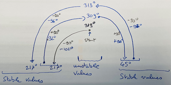

I start my board which is initialized at an Angle X (yaw axis, here 319°).
Then I rotate (counter clockwise) of -90°. The yaw result is now 217. The rotation angle value is 102° then.
After that i get back to my starting angle. The read Yaw value is now 309°, (so a rotation of 92°).
Now when rotating clockwise of 90° (from start position) I get 45° (so a rotation of 96°)
When getting back to the starting position, i'm now at a yaw angle of 313° (so 92°)
And now i get back counterclockwise to my -90° first rotation.
Guess what. The yaw angle is back to 217° If i were to go to the +90° angle, i would also be back to 45°.
So it seems that our 0° values are kind of shifted after the rotations. Would you know what could be the issue?
 Edit : Note that the Heading and heading error in the data log are used to debug (Heading just returns the result of a register parameter and heading error is the yaw angle calculated from the magnetometer output only (yaw_mag = 180 * atan2(MagValue.y, MagValue.x) / M_PI; ) so they wont be relevant for the issue
You will find here an illustration of the movments performed with noted in blue the read angle and in black the true rotation.0693W00000GYZyDQAX.png

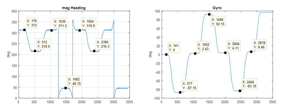

Miroslav BATEK
here is response from my colleague who is expert on sensor fusion:
At the start of the MotionFX, heading is initialized with zero degree and will initial the heading value using magnetometer value only when there is a motion.
This is done to make sure magnetometer is calibrated and it can be determined only when there is some rotation. Therefore, the customer is seeing 0 at the beginning but after rotation, it converges to 217 deg.
When I compare the rotation from mag and gyro : Here is the value I am getting
Heading from Magnetometer : [-97 (313->216), 95, 95, -95, -95]
Heading from Gyro integration : [-87,90, 90, -88, -88]
The differences in both sensors show some calibration issue with magnetometer but it is acceptable. As MotionFX get more data, it tends to handle the error better due to better observation of error.
