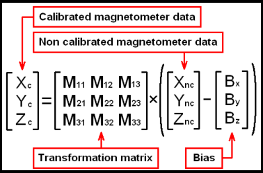

I'm currently working on a project requiring to get X, Y and Z angles from 2 sensors, (IIS2MDC and ISM330DHCX). In order to do so, I use MotionFX and its 2 functions, MotionFX_propagate and MotionFX_update, both used to run Kalman STM's algorithms.
Everything works fine on the X and Y axis.
However, the Z axis is not responding as it should:
While the board is on it's first side, the Z angle is correctly read and computed. If the board is rotated of 90°, the result returned is indeed 90°.
But if the board is fliped on its other side, the angle I get is 60°.
Furthermore, that behavior is no observed if the data is acquired and processed as a 6-axis acquisition.
Has anyone observed such an issue? Could it be a magnetometer calibration or a sensor setup issue?

Hello Miroslav,
I tried to create a log for you yesterday but i couldn't with our custom board so i made one myself with measurements.
Note that there is a x0.1 factor applied before displaying those data. They are the direct output of the magnetometer (in mG) *0.1 after hard iron calibration.
Hope this will help.
Would you know if this is soft iron error how i could compensate it? I found some hints on internet but i don't know what values i should use.

Maybe this will be better for you to understand.
‎2021-10-24 11:20 PM
Here is also a data log of uncalibrated data. I have also added to the previous data log graphics. Note that if the value jumps at some point from -180 to 180, that may be because i wanted to add more data but failed to do so from the previous orientation of the board.
