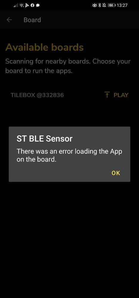

Problems to pair SensorTile.box to ST BLESensor Application. Basically it scans for nearby boards and then gives an error loading the App. What can I do?

HI @ATrif.1​ ,
which application are you trying to upload on your SensorTile.box? An already-built one (Mode1) or a custom one (Mode2)?
I see that the, so you correctly paired the devices, right (using the 123456 code)?

Hi Eleon,
Basically I follow this pathway : Create an application - Vibration Monitor - Vibration Monitor compare.
And the first time SensorTile.box was connected to the mobile App i used 123456 code to pair it.
Hi @ATrif.1​ ,
It might be related to the Vibration Monitor compare only. Are you facing the issue also while uploading other predefined apps?
The "Vibration Monitor compare" needs a csv file on the SD card, which is the reference for the vibration monitor comparison. You can create it in a first step, writing an acceleration pattern on the SD card, and then try again uploading the Vibration Monitor compare app.
-Eleon
Hi Eleon,
Well, I also tried to upload other predefined apps, but unfortunately this problem persists.
Hi @ATrif.1​ ,
does the problem persist with all the predefined apps or only with some ones?
-Eleon
Hi @Eleon BORLINI​
The problem persists with all predefined apps, can the problem be with Bluetooth protocol?
Hi @ATrif.1​ ,
it might be... you might try to restore the Sensortile.box firmware to the factory one in the way described in this post (LINK), but not sure this can be the solution.
-Eleon
