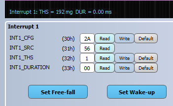

I have an mis understanding about the resolution of the INT1_THS register acoording the selected scale.
This register is 7 bit value , so:
for FS= 2g  1LSB = 2/127 = 16mg  OK with the datasheet
FS= 4g  1LSB = 4/127 = 32mg  OK with the datasheet
FS= 8g  1LSB = 8/127 = 62mg  OK with the datasheet
FS= 16g  1LSB = 16/127 = 125mg  KO with the datasheet, according the datasheet 1 LSB = 186mg
and if I put the 0x01 int the INT1_THS with my bread board and unico I have 192mg
What's the correct value?
Other question:
I'm using high resolution mode with 10Hz for ODR and FS 16G. so the resolution is 12bits.
In the specification, the sensitivity for this setting is 12 mg/digit. but this not match with 12bits ...
What's the Fifo resolution in this case?
Best regards
wilfried
Posted on May 03, 2018 at 09:48
The correct value of 1LSB threshold fro FS = 16G is 186mg. The sensor has different sensitivity in case of 16g range.
FIFO stores only 10 bit values.

wilfried walezack
The software is UNICO from ST. This is a usefull software for test the ST devise as MEMS sensor.
