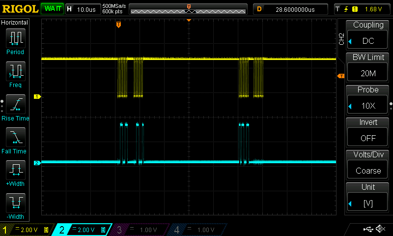

HI,
Please find bellow scope capture of the SPI communication
Yellow curve -> clock
blue curve -> MOSI

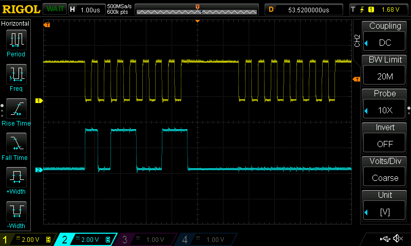

1) Write 0x31 into 0x33 register (LIS3DH_INT1_DURATION) - > Write OK
and Read 0x33 register -> Read OK
2) Zoom on the Reading communication of the 0x33 register-> Read OK

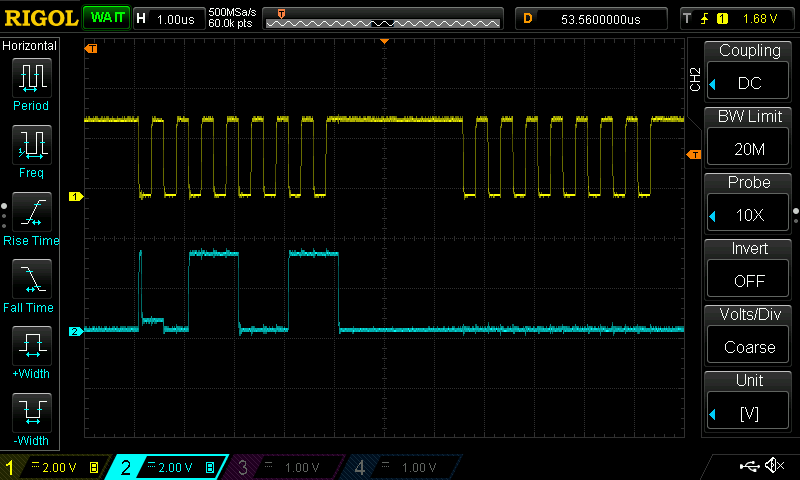

3) Write 0x32 into 0x33 register (LIS3DH_INT1_DURATION) - > Write OK
and Read 0x33 register -> Read KO (you can see distorsion of the data )

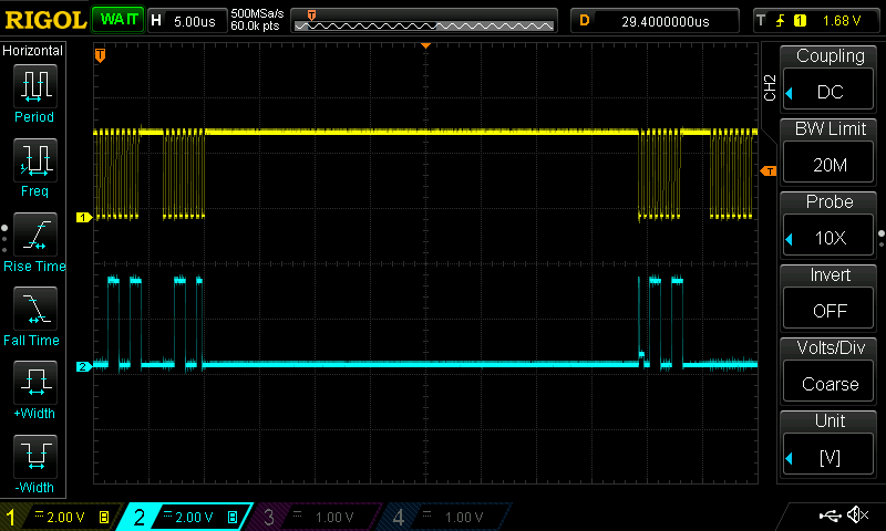

4) Zoom on the Reading communication of the 0x33 register-> Read KO
On the picture 4, we can see that the LIS2DH pull down the bit7 of the data.
SPI frequency is 2Mhz.

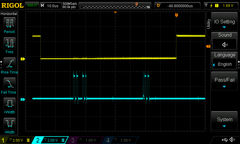

‎2018-02-23 7:18 AM
Yes, the SPI mode is set to Mode3.
I tried with reset CS after writing, and also to held high the CS signal between writng and reading, but the result is the same. bit 7 are already pull down.
see below
if I put 100ms between the writing and readin, same results...
‎2018-02-23 7:48 AM
When the second LIS2DH pull down the bit7 of the data, it actually does acknowledge of his address 0x31.
Unfortunately I don't see the CS signal, but I suppose you don't reset and set CS signal between write and read operation and this cause the problem. Can you please check it?
The SPI mode should be mode 3, but I suppose you are using this mode.
‎2018-02-23 8:34 AM
I though the CS driven from the same pin with an invertor.
You should also toggle the CS signal on the second sensor, it should be break the unwanted I2C communication.
Anyway it is strange the second sensor accept the communication as I2C, it meas there must be a start bit (SDA high to low with clock high), but it should not be there.

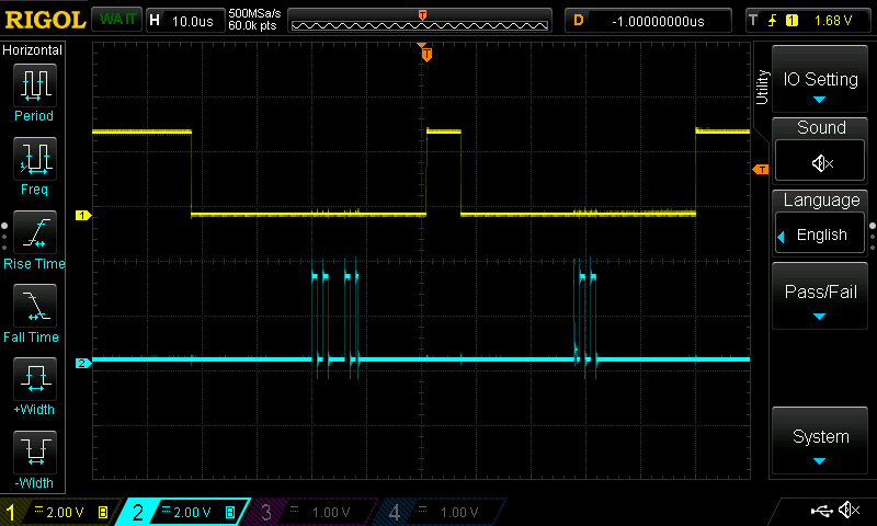

‎2018-02-23 8:38 AM
OK,
if I toogle the CS of the second LIS2DH, the SPI communication is OK, I can now write the value 0x32 into the register 0x33, and also I can read it.
Your 2nd proposal seems to be working. but I'm confuse with this solution. Normally with the SPI communication, we do not have to toogle the CS of the other device.
Could you give me more information about your first solution (inverter). It's not clear for me.
Regards
‎2018-02-24 3:35 AM
'Your 2nd proposal seems to be working. but I'm confuse with this solution. Normally with the SPI communication, we do not have to toogle the CS of the other device.' You are right, this is not common, but please be aware the the CS of the sneor is not only chip sellect but also switch between I2C and SPI bus. So the inactive sesnor with CS=1 is listening the communication and expect I2C data. When you send the data 0x32 it is actually I2C address of the sensor and the sensor make ACK which disturb your SPI coomunication. When you togggle the CS pint, you interrupt the I2C communication and the sensor cannot do the ACK.
