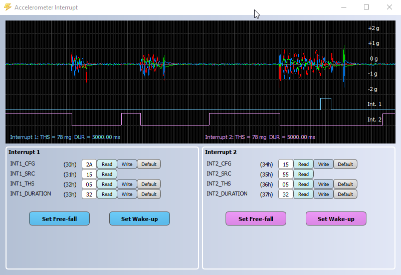

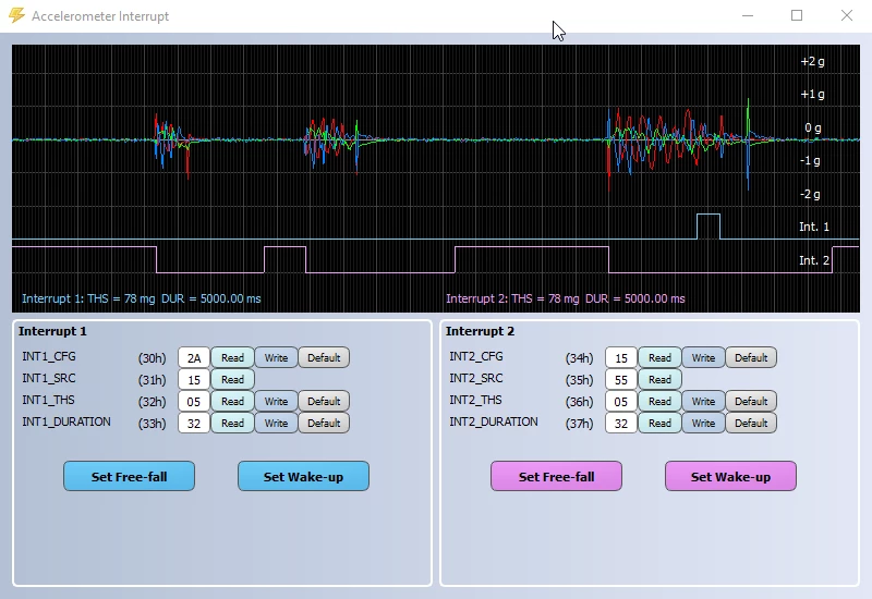

    Please see below my configuration, it seems to me it works well.
    ABast.4

    If even only one sample will be under the threshold the interrupt won't be triggered, basically in your case each sample bellow the threshold will reset the duration counter. I don't know what is your exact target, but usually these detections are not 100% accurate, the threshold is different for each activity like for example working on PC, walking, sitting in car, ... and it can vary person by person, also it depends on the position of the sensor (on wrist, in pocket, ...)
    STEVAL-MKI109V2 or  STEVAL-MKI109V3 cooperate with Unico application, which is able to record data and store them into text file. 15 minutes is not a problem.

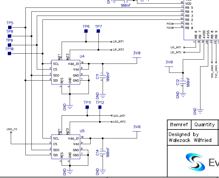

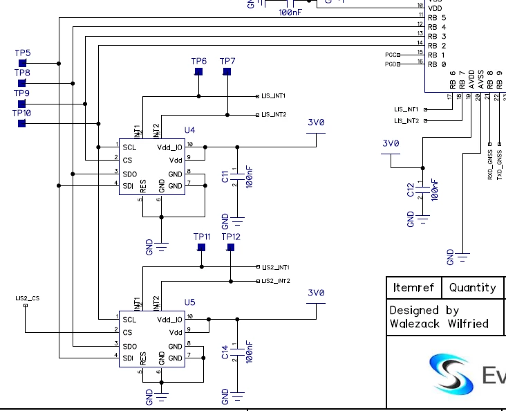

    But I have a strange running on the SPI bus when I use 2 LIS2DH,
    When I connect and use only one LIS2DH, all are OK, but on my final board I have 2 LIS2DH connected to the same SPI bus. I drive the CS pin on each sensor for set parameters on the selected sensor.
    I can't write the value 0x32 into the register LIS3DH_INT1_DURATION(0x33), when I read after the write operation the value is 0xFF. I have no problem with the value 0x31 and 0x33, but only with the value 0x32.
    If I disconnect the 2nd LIS2DH, the writing operation is OK with the value 0x32.
    I checked my schematic (see below). All it's OK.
    Is very crazy, I havn't explanation. Do you I have an idea?
    thanks a lot for your support!
    wilfried
    February 21, 2018
    Posted on February 21, 2018 at 21:35
    I think, I have an explantion, the second sensor which has CS=1 is actually expecting I2C command and the 0x32 is write address of the sensor on I2C bus. So it interract with your SPI comunication. Can you please capture the comunication on the SPI bus by scope or logic analyzer? You should not create I2C start condition with the SPI communication.

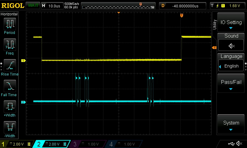

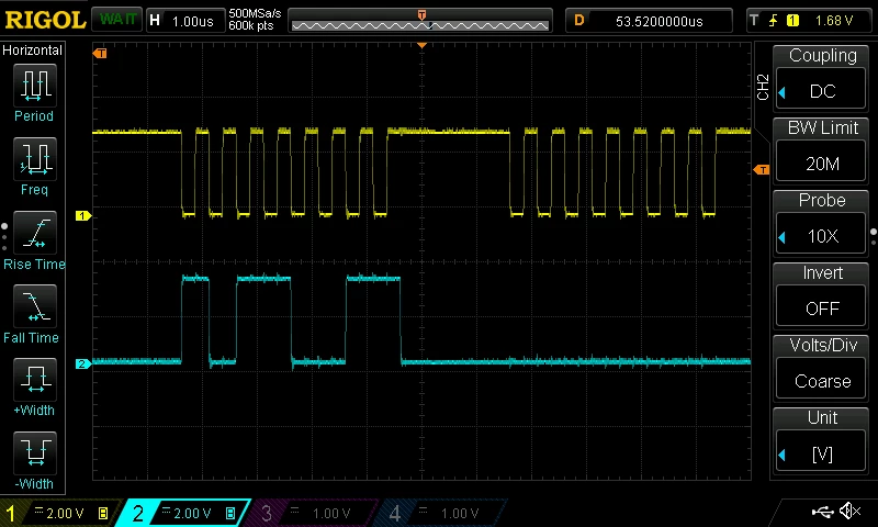

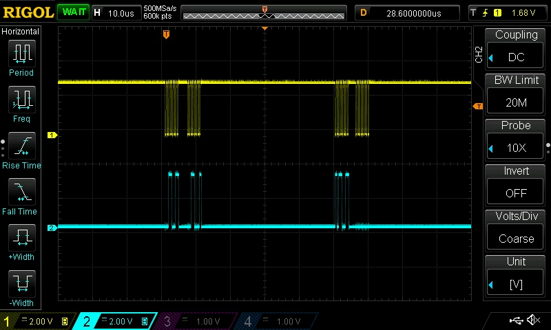

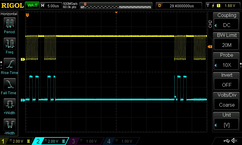

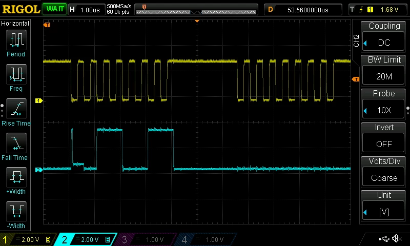

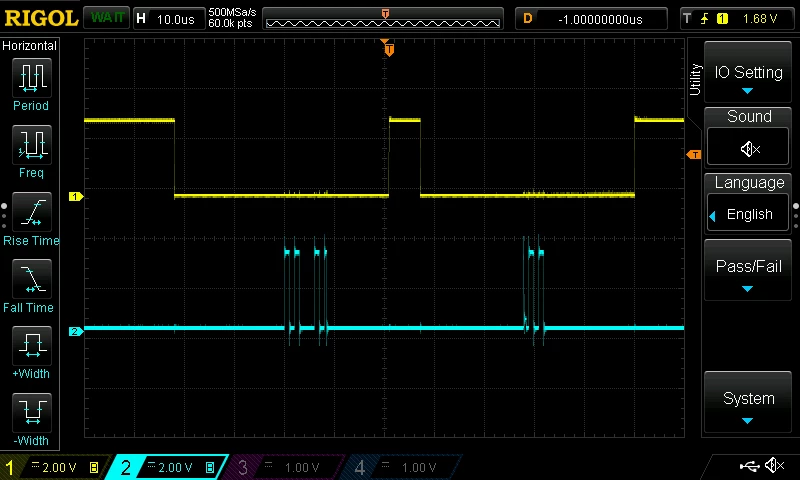

    Please find bellow scope capture of the SPI communication
    Yellow curve -> clock
    blue curve -> MOSI
    1) Write 0x31 into 0x33 register (LIS3DH_INT1_DURATION) - > Write OK
    and Read 0x33 register -> Read OK
    2) Zoom on the Reading communication of the 0x33 register-> Read OK
    3) Write 0x32 into 0x33 register (LIS3DH_INT1_DURATION) - > Write OK
    and Read 0x33 register -> Read KO (you can see distorsion of the data )
    4) Zoom on the Reading communication of the 0x33 register-> Read KO
    On the picture 4, we can see that the LIS2DH pull down the bit7 of the data.
    SPI frequency is 2Mhz.
    I don't send START condition, just SPI communication to the LIS2DH sensor.
    Could you pls help me to solve this issue?

    When the second LIS2DH pull down the bit7 of the data, it actually does acknowledge of his address 0x31.
    Unfortunately I don't see the CS signal, but I suppose you don't reset and set CS signal between write and read operation and this cause the problem. Can you please check it?
    The SPI mode should be mode 3, but I suppose you are using this mode.

    I though the CS driven from the same pin with an invertor.
    You should also toggle the CS signal on the second sensor, it should be break the unwanted I2C communication.
    Anyway it is strange the second sensor accept the communication as I2C, it meas there must be a start bit (SDA high to low with clock high), but it should not be there.
