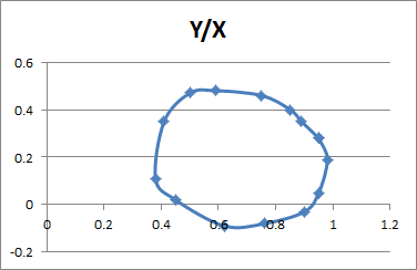

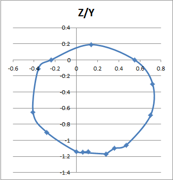

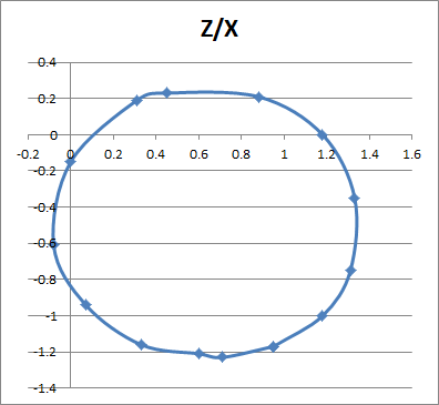

I think the orientation for the LSM9DS1 is 'NEU' for acc and gyro and 'SEU' for the magnetometer.
The 8 shape should be done in 3D space, but you can also do circle along each axis.
If you are able to draw mag data in X-Y, X-Z, Y-Z 2D charts it would be helpful.
I expect you enable the sensor fusion and mag calibration somewhere in your program.

MFX_MagCal_output_t mag_cal_test; MotionFX_MagCal_getParams(&mag_cal_test); MotionFX_manager_start_9X();Here are my charts:
Looks like there is a big soft iron distortion because the dependence isn't spherical but elliptical.
