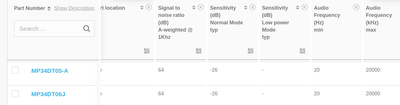

‎2024-08-06 7:59 PM
Can't find in datasheet, but product table states as 20 kHz
https://www.st.com/en/mems-and-sensors/mems-microphones/products.html

‎2024-08-06 10:29 PM
Thanks to you both for this response. I think I will just compromise at the 20khz so I can simplify the model and just use the built-in mic on the ardunio. If I get a researcher who wants a perfectly accurate model, I will give him the specs to the upgraded model that can detect this range. I'll be sure to share the end result when I have it working
