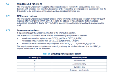

What is Wraparound functions in LSM6DSO32?
how to implement it?
Do you have example code?
I am using TI microcontroller TMS570LC4357
1 REPLY 1
MSelv.3
I want to read all data of FIFO at a shot through I2C
How to do it?
