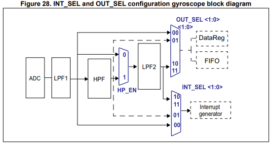

I get it. Still related to this, where can I get the values table for INT_SEL and OUT_SEL in CTRL_REG2_G (11h) ?
Thanks
Eleon BORLINI
September 29, 2020
Hi @PRebo.1​ ,
the INT_SEL and OUT_SEL meanings are explained in the diagram of Figure 28.
  • OUT_SEL value determines the filters applied on the output data stream
    • 00 dataout with LPF1 only applied
    • 01 dataout with HPF (and LPF1) applied
    • 10 or 11 dataout with LPF2 (and LPF1) applied
  • INT_SEL value determines the filters applied on the data that generate the interrupts
    • 00 interrupt with LPF1 only applied
    • 01 interrupt with HPF (and LPF1) applied
    • 10 or 11 interrupt with LPF2 (and LPF1) applied
