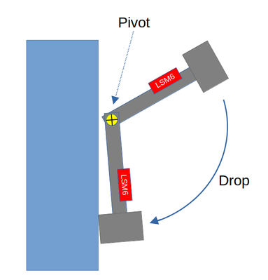

Mechanical Setup:
In order to examine the problem we build a simple mechanical setup and recorded some data with it:
We attached the LSM6DSV32X to a metal bar that pivots around an axle attached to a solid wall. During the recording we lifted the unrestrained end of the metal bar up and dropped it, causing it to hit the wall. After the impact of hitting the wall, the metal bar bounces back and forth a few times.
We repeated this several times over multiple recordings.

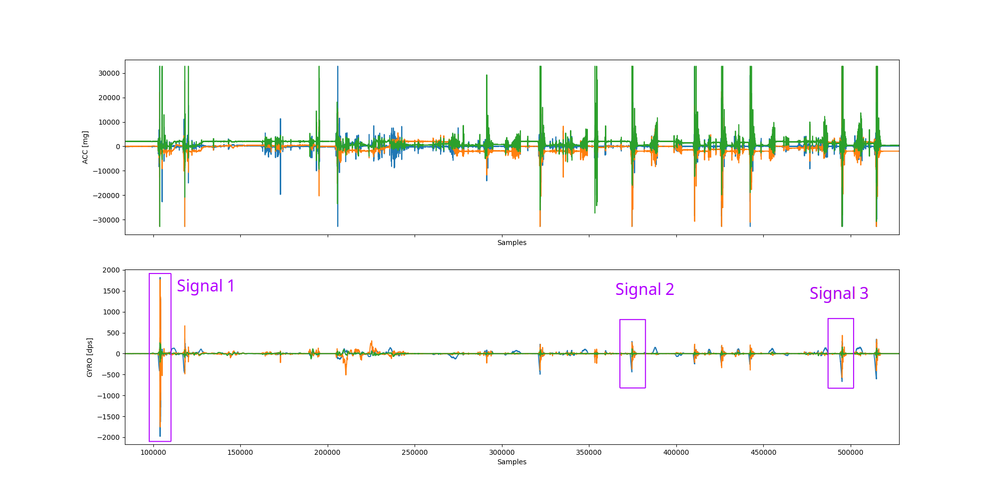

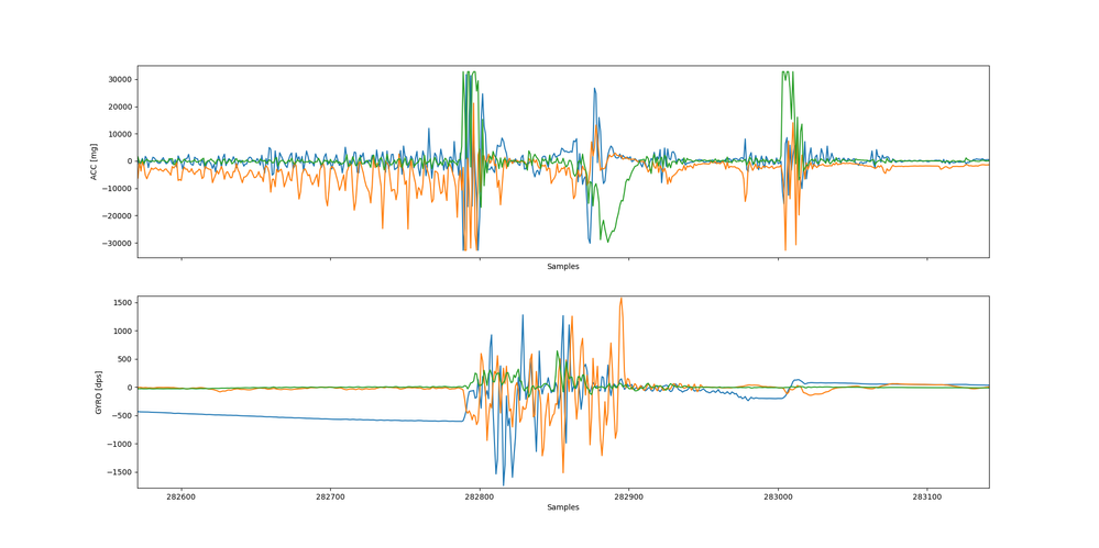

This is what the first recording looks like:

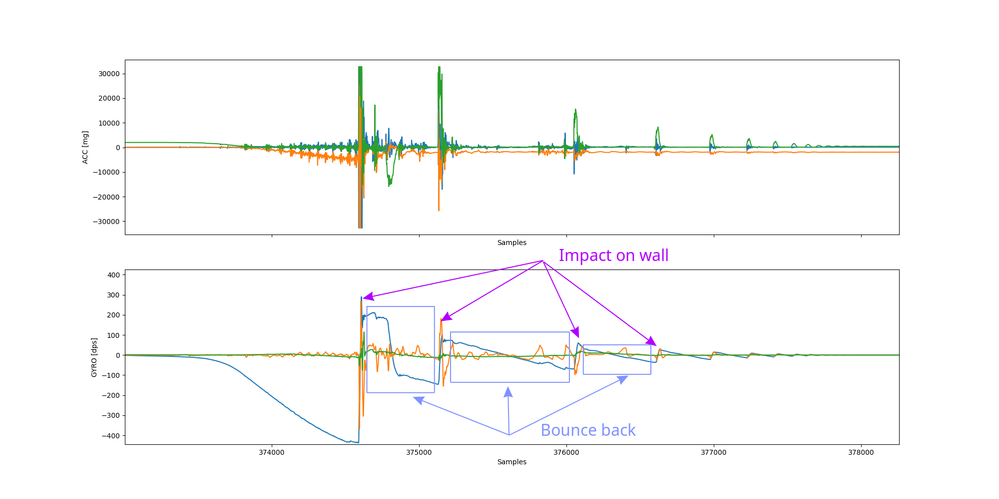

Both Signal 2 and Signal 3 look as expected with gyroscope amplitudes of around 400 dps. Here is a close up of Signal 2:
And a close up of Signal 3 (different time scaling in the plot, but very similar to Signal 2:(

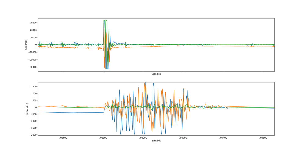

However Signal 1 looks completely different. Here the gyroscope amplitudes are close to 2000 dps and the expected patterns of impacts and bouncing back are not visible.

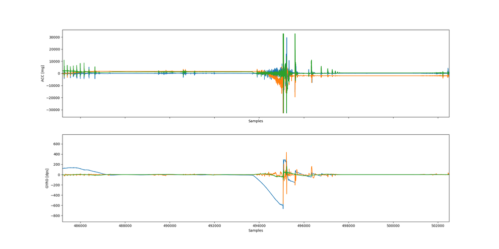

To be sure we did more recordings and while most of the signals looked good, there were several more signals that looked like the example above.
Here is another example:
Question:
For the most part the accelerometer signals look fine, so the problem seem to be in the gyroscope channel only.
During the impacts the accelerometer is almost always clipping (>32G). For our application this is not an issue, however we are wondering if this might cause issues for the gyroscope.
--> Is it possible that we sometimes get artifacts in the gyroscope channel because the accelerometer is clipping?
--> What else could be the problem and cause these artifacts?

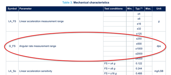

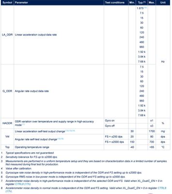

About maximum acceleration for the gyroscope:
You wrote:
"Mechanical characteristics portion of the datasheet has the details you are looking for."
This is what the datasheet provides:
I cant find a specification for a maximum acceleration for the gyroscope.
Kinemic GmbH

I’m sorry, I made some poor assumptions of your understanding of this subject.
The gyroscope data you want is here -
The sampling rates would need to increase, not lower, to lessen the distortion.

‎2024-11-05 2:51 AM - edited ‎2024-11-05 2:51 AM
This is the angular velocity measurement range of the gyroscope. In our case we set it to +/- 2000 dps.
As I wrote in my original post, the signals we were measuring have a magnitude of about +/- 400 dps, so they are well within the measurement range.
I will try to clarify this:
The signals we are measuring have moderate angular velocities (~400 dps) but, for short periods of time, very high linear accelerations of much more than 32 g. When measuring these signals we expect the accelerometer to go into clipping, however the gyroscope should still yield useful data.
But as you can see in my first post, when the accelerometer goes into clipping the gyroscope sometimes also produces incorrect data.
So my question was really: Apparently the gyropscope is affected by high linear accelerations. Is there any information in the datasheet about the maximum linear acceleration under which the gyroscope still functions properly?
