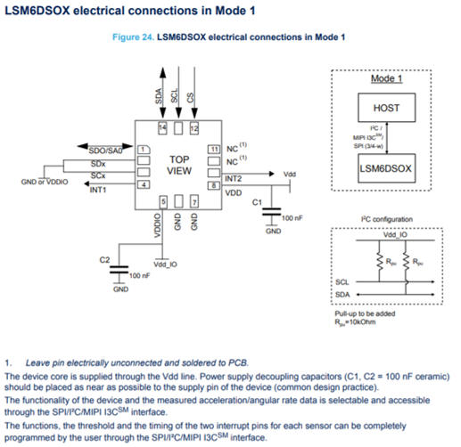

I am working with lsm6dso sensor for a watch. At the beginning, I am using ​the follwoing function to get steps in the register. It works in a while loop and can work rightly.
int32_t lsm6dso_number_of_steps_get(stmdev_ctx_t *ctx, uint8_t *buff)
 int32_t ret;
 ret = lsm6dso_mem_bank_set(ctx, LSM6DSO_EMBEDDED_FUNC_BANK);
 if (ret == 0) {
 ret = lsm6dso_read_reg(ctx, LSM6DSO_STEP_COUNTER_L, buff, 2);
 if (ret == 0) {
 ret = lsm6dso_mem_bank_set(ctx, LSM6DSO_USER_BANK);
 return ret;
Then I want to put this function in another thread. But it seems to work right. It works for a while at first, but after running for some time, the number of steps will automatically reset to zero.
I want to know under what condition will the sensor reset. Does the multithread affect its function?

Hi @JXiao.1​ ,
first, I'm glad you managed to make the step counter with LSM6DSO working.
About the current issue, the only way the chip could reset is the case you deliberately enabled the SW_RESET bit of CTRL3_C (12h) register (datasheet p.53) but it seems not to be the case, or the Vdd falls below the minimum value (i.e. 1.71V). I'm wondering if there could be some issue coming from the multithread operation, for example due to interrupt handlers: is the hardware connection compliant with the connection suggested in the datasheet p.35?
Moreover, do you have the possibility to acquire (e.g. with a scope) the Vdd line during the multithread operation? Can you also check whether the configuration registers' values are 00h just after the step counter resets to 0?
-Eleon

Thank you for your anwser.
Now the ​reset bug can't be duplicated and I can't make sure when it can happen. I will obeserve more.
And I have a question about sensor setting. Can I use code to control the power mode of sensor? Because I want to set the sensor not work in some conditions to save power. Or I need to set pins to zero to turn off the sensor?​
