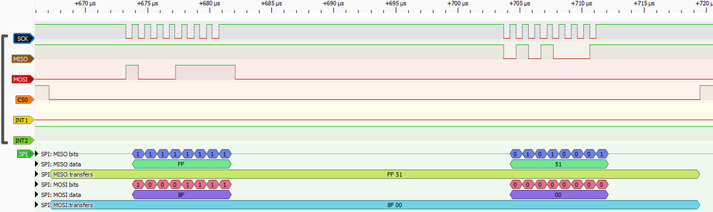

I know the thread is pretty old but I'm having a similar issue.
I'm trying to communicate with an LSMDSO on STEVAL-MKI196V1 and they always return 0x50 or 0x51 to the read of the WHO_AM_I register.
Connection is similar to many others:
-Vdd = 3.3v
-VddIO = 3.3v (tried also with 3.05V as the voltage in the microcontroller board is ~3.05V)
-SDO = SPI MISO
-SDA = SPI MOSI
-SCL = SPI clock
-CS = SPI chip select (Negated, 270kOhm pull-up)
-SCx = GND
-SDx = GND
-GND = GND
-OCS = floating
-OSDO = floating
The scope shows clean edges.
If I ignore the WHO_AM_I, I can configure the registers. I can configure resolution, frequency, interrupts, etc. To be honest, I have another issue as INT1 is triggered with accelerometer data, but when I try to check STATUS_REG, the flag XLDA is always 0, but that might be an issue with the configuration.
This is a capture of the logic analyzer in the WHO_AM_I register reading:
What I found weird is that this behavior is consistent when the supply is stable, but then I realized that if I turned off the LDO, VCC didn't really go to 0V due to leakage from logic analyzer and microcontroller, it stayed at ~2.4V and at that voltage, WHO_I_AM returns 0x6C!!!
The behavior is exactly the same on both STEVAL-MKI196V1 I have.
Is there any explanation for the error in the WHO_AM_I register???
‎2023-02-07 10:23 AM
IIRC my own problems went away when I switched to a PCB from a breadboard. You may want to look at the signal with a fast, calibrated scope to see how far it differs from an ideal square; if its gnarly your logic analyzer might see different bits than the ST part does anyways
Check out the thread here, and then the other thread it links to in the main question for some scope traces and further discussion
https://electronics.stackexchange.com/questions/33372/spi-bus-termination-considerations
