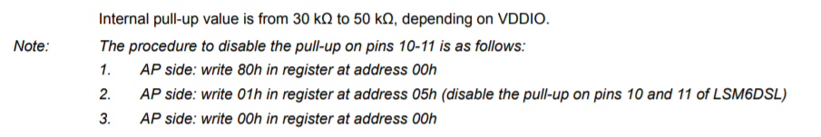

In the process of detecting the power consumption of the sensor, it was found that the power consumption of lsm6dsl reached 2mA or even more. It can be shown in the user manual that the power consumption of the high-performance mode is 0.6mA, I don’t know why it is so high?

Hi @Slong.1​ ,
my first guess is that the extra power consumption could be coming from the hardware connections of LSM6DSL pins.
Can you please check pin 10 and pin 11 configuration? They should be left unconnected. Otherwise, as reported in the datasheet, p.47, they have:
0693W00000HpD4kQAF.pngIn addition, are you using SPI or I2C protocol?
-Eleon
