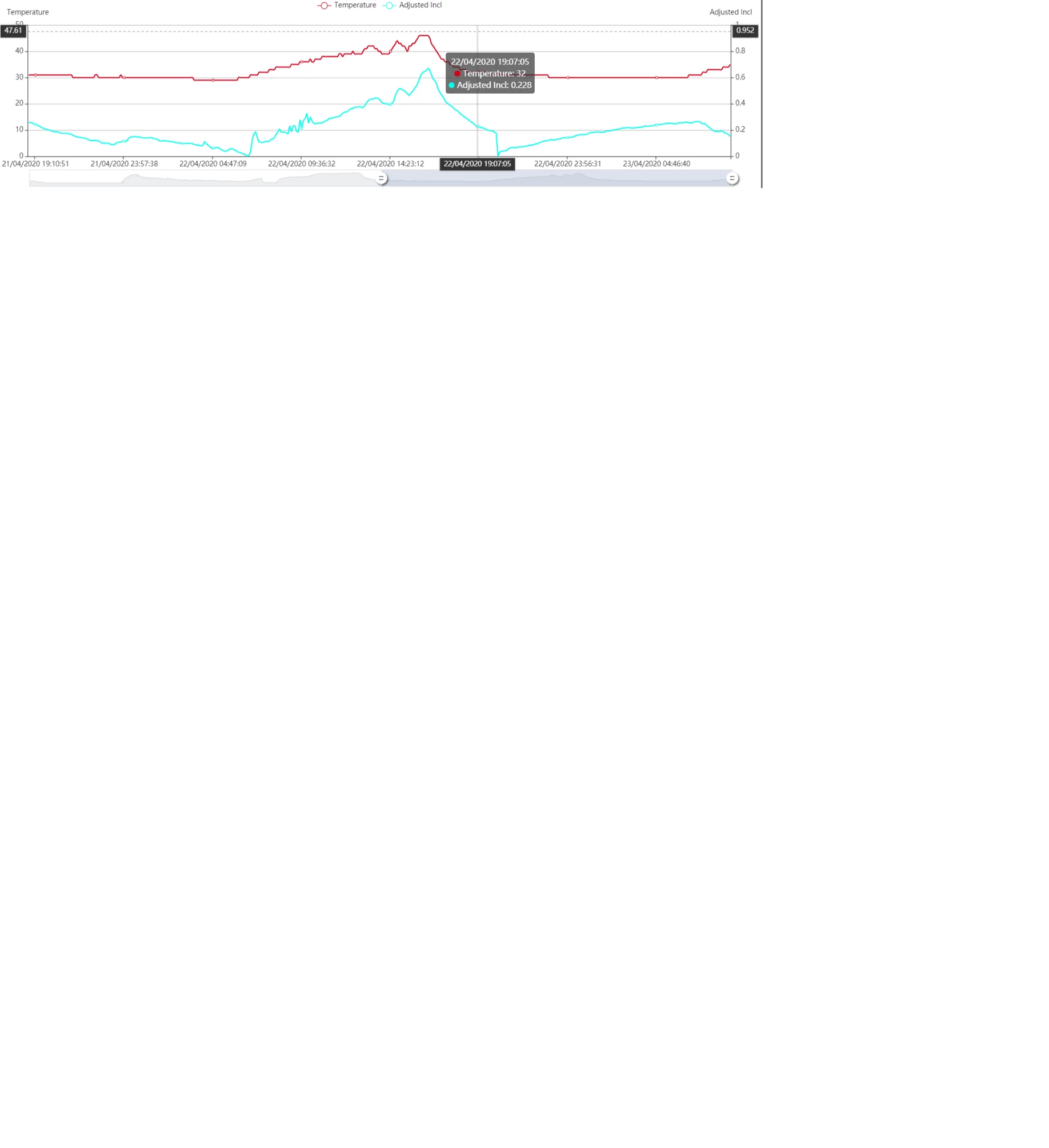

As I tested with, the LSM6DS drifted follow temperature. As you can image bellow, red line is temperature and green is degree (was calculated from X, Y, Z )
I'd like to confirm LSM6DS had internal temperature compensation? If NO, how to do it? Or any chip was integrated build-in this feature?

Hi Tuyen, the internal temperature sensor is calibrated at production tester level, while the ZRL and ZGL temperature variation gain is declared in the datasheet p.21. I suggest you to compensate via SW (real-time or in post-processing) the output data with the declared average temperature variation, positive for increasing temperature from 25°C, and negative for decreasing temperature.

I had a concern that all chip LSM6DS impact by temperature are same as +/-0.5mg/1 degree?
We also found that, It is small effect when we put horizontal and big effect when put vertical. Any different impact through 3 axis X, Y, Z?
regards,
Tuyen
Hi Tuyen, +/-0.5mg/1 degree is the typical value, although max and min values are not declared, mostly because they depend on the application environment, the soldering process (e.g. offset introduction due to an unwanted bending), the process spread. In the case you are finding outliers, a post-processing / average compensation is suggested... The impact on the 3 axis is similar for each other, although Z can be slightly asymmetrical with respect to X and Y axis, for mechanichal design reasons. Regards
