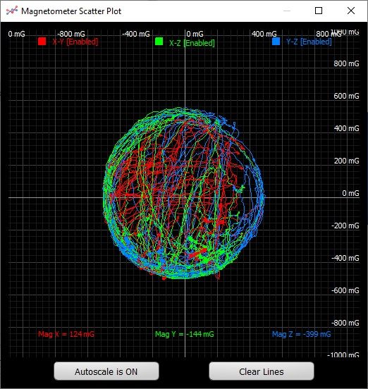

please see the scatter plot after calibration. I also attached the data log of Unicleo GUI. The board is static at the table. The heading values are constant (but incorrect) while the heading error increases. What does the "heading error" value represent and why is it increasing.
Thx,
Marten
