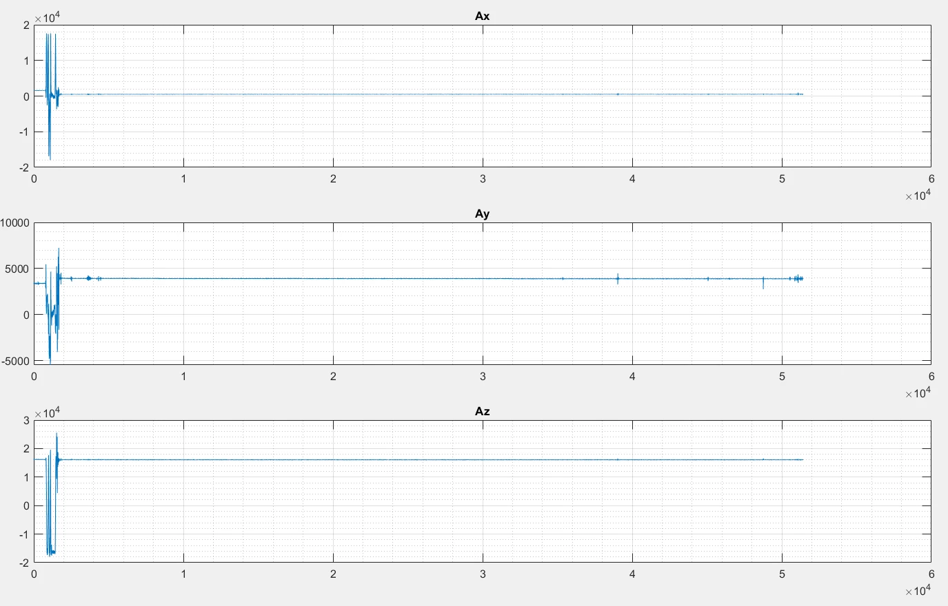

Here is what I can see when I plot Gyros and Accelerometers Datas.....

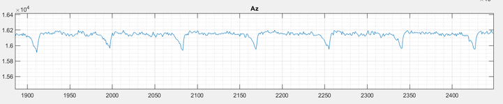

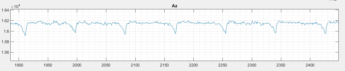

First LSM6DS3 is stand still on a plate, then I can see some kind of pattern on signals, this pattern is the exact period of FIFO FTH !!!! How can it be ???? (figure : FIFO FTH = 1032words of data, so 1032/6 = 172, spikes appears every 172 samples) We get the same with half FIFO FTH (516words, spikes appears every 86 samples )

At first sight, I have already take time to compare between data as they are printed in the terminal, and the data in file written on the sd card, and there is no difference.
I managed to use theINT1 pad configured on drdy flag to catch only Z axis of the accelerometer and it seems there is no more pattern, but that is not usefull for me to keep doing so....
The spikes you can see on previous picture is not the first data of the batch, the thirteenest as I remember

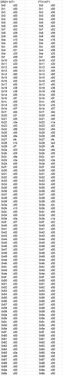

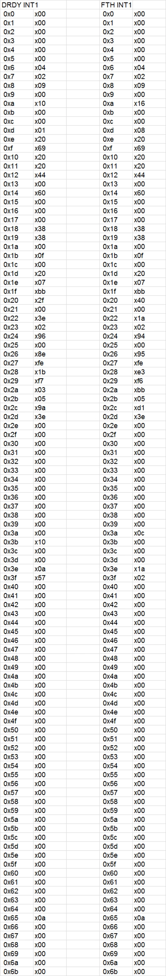

I post you my configurations for both DRDY on INT1 and FTH on INT1
To be precise it is the complete map of LSM6DS3 registers

I have made a correction ...previously LSM6 was connected with usb link and had 5 volts on VDD !!
Correction is made and now 3.3v. I keep capacitor, 1µF between VDD and GND near LSM6 board and another one between VIN (5v from USB) and GND of the PYboard

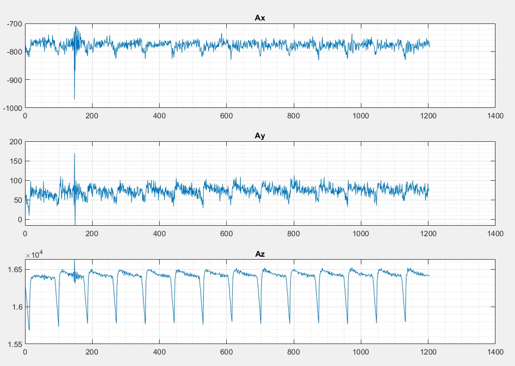

The program using FTH on INT1 still show a pattern every FTH samples....(here every 86 samples FTH =0204h (516d) 516/6=86, SDCard write is done just after. Oscilloscope shows a 3.46-3.54 volts between LSM6 VDD and GND pins, with no variation
here is a global view...
only Az shows a significant pattern...

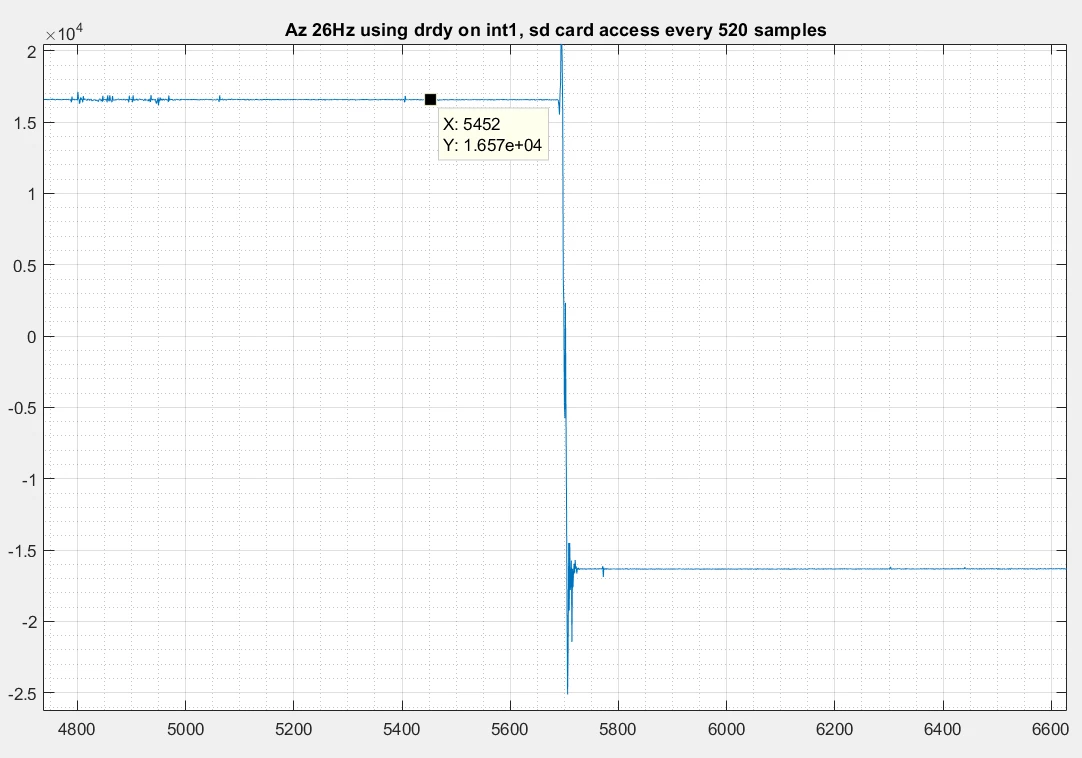

The other program using DRDY on INT1 does not show any pattern, SDCard writes are done every 520 samples (only Az is stored (from LSM6 registers 2Ch,2Dh))
