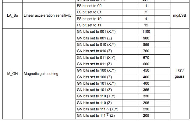

I'm not sure if I did the reading function properly. I'm getting data, but I don't know how to convert it further to be able to calculate the azimuth. Should I divide them by sensitivity or what? I can't find such an information in the datasheet

To convert raw data into acceleration in g and magnetic field in gauss you have use the sensitivity. defined in datasheet.
Basicaly for acceleration you multiply the raw value by sensitivity (LA_So) for magnetometer you divide the raw value (M_GN).

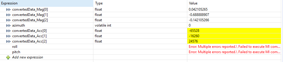

I have divided the raw data from the magnetometer
convertedData_Mag[0] = (float) ((int16_t) ((XYZ[0] << 8) + XYZ[1]))/LSM303DLHC_M_SENSITIVITY_XY_1_9Ga;
convertedData_Mag[1] = (float) ((int16_t) ((XYZ[2] << 8) + XYZ[3]))/LSM303DLHC_M_SENSITIVITY_XY_1_9Ga;
convertedData_Mag[2] = (float) ((int16_t) ((XYZ[4] << 8) + XYZ[5]))/LSM303DLHC_M_SENSITIVITY_Z_1_9Ga;
and multiplied the raw data from accelerometer (I selected 2g sensitivity)
for(i=0;i<3;i++)
        convertedData_Acc[i] = (float) ((int16_t) ((XYZ[2*i+1] << 8) + XYZ[2*i])) * 2.0f;
and I'm getting such results
I think there's something wrong with accelerometer. Magnetometers values seem to be good.

The accelerometer value need to be divided by 16, because it is 12-bit value left adjusted in 16-bit register.
And I see another problem in your latest code, you have case the type of XYZ to uint16_t before you do the shift (<<8) as you did it in the first version.
