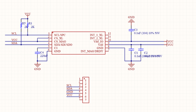

The chip is used to calibrate the orientation of the compass, but it is very easy to be interfered with and has the following two problems
1 Calibration is very difficult to calibrate, you need to shake the sensor many times
2. After calibration is done it is very susceptible to interference, resulting in inaccurate compass data
Below is the circuit diagram, if you have a mature circuit please send me to see if there are other solutions to the problem.

Hi @FRT_ST ,
Your schematic is ok, can you explain me which issues you are experiencing?

Hi @FRT_ST ,
The hardware is correct, probably is something related to your software.
Our PID examples could help you for debug!
