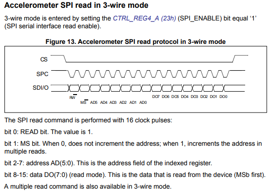

Hi
I have lsm303agr mems sensor with stm32g4. It uses 3 wire SPI mode. I have problem with SPI communication. I used CubeMX with HAL mode and STMems_Standard_C_drivers for lsm303. The problem is that, when i read whoami register it reads 0x33 which is correct. But the next time i read as 0. Next time again 0x33 and so on. It reads 0x33 and 0 sequentially. SPI times out. I have seen HAL examples written only for Full duplex communication. So, i used CubeMX with SPI in half duplex mode to generate the project. This is my code snippet:
while(1)
HAL_GPIO_WritePin(GPIO_Sensor, CS_Sensor_Pin, GPIO_PIN_RESET);
HAL_Delay(1);
HAL_SPI_Transmit(&hspi1, &whoami_addr, 1, 1000);
HAL_SPI_Receive(&hspi1, &whoami_val, 1, 1000);
HAL_Delay(1);
HAL_GPIO_WritePin(GPIOA_Sensor CS_Sensor_Pin, GPIO_PIN_SET);
Am i missing something with SPI 3-Wire mode?
Best regards.

Eleon BORLINI
Hi @AAYKA.1​ , can you check how you configured the SPI at master side (8bit or 16bit)? Did you perform multiple readings continuously? And after which event does the SPI go in timeout? Here below is the 3-wire SPI data pattern (p. 41 of the datasheet), please check if you followed all the indications. Appreciated if you can share the pattern analyzer data.
Regards

Hi Eleon
Thanks for your answer. I have found STML476 discovery boards which has magnetometer with 3 wire. And i used that in my code. Then i succeeded in SPI write/read. Now we have another problem. I use LSM303. I read accelerometer data, temperature data correctly. They give me reasonable values. But magnetometer values are not so reliable. For example i get y-axis values always negative. So my angle values are strange. I used STMems_Standard_C_drivers which has LSM303 driver and i used its initilization procedure to program registers. What can be the cause of this problem? By the way, I get this values from raw data, i didnt include Motion library yet.
Best regards.
