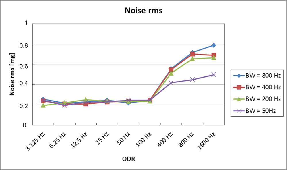

2) on datasheet it's reported typical noise spectral density (150 ug/Hz) at 100 Hz data rate, are there available noise values for different ODR?

  2. Here below a more complete overview on noise spectral density vs ODR (characterization, not datasheet, data)
