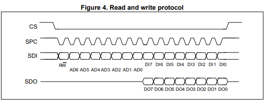

Can someone confirm which SPI mode (0 thru 3) LIS3DHH uses?
It is not explicitly mentioned and from the diagram it seems to be either mode 2 or mode 3 (which start with clock high), but then I'm not too sure.
2020-06-29 10:48 AM
Hi @tonypdmtr , the picture at p.12 of the device datasheet shows the SPI mode3, with CPOL = 1 and CPHA = 1.
Regards
