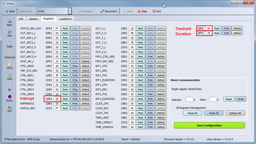

The activity/inactivity detection is functional.
I think the problem is in your configuration, you set the threshold to250 mg which is always below the 1g caused by the gravity. If you sent it above the 1g it should start to work. Please see my configuration below, I highlighted the settings related to the functionality.
I think the functionality is available even in old components (before
Jan 2017), I tested it with older one. It was only not exposed in the datasheet.
Anyway I will double check this information.
‎2017-05-19 05:49 AM

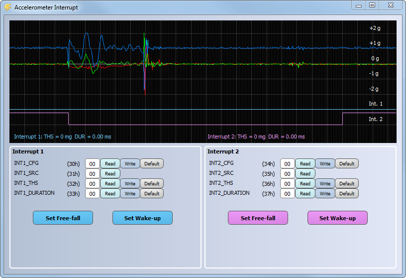

Thanks again. Meanwhile I found a much smarter solution on the web, which allows me to have activity/inactivity detection at 1Hz ODR and low-power-mode (2uA) by 'abusing' free fall detection. Very smart. For anybody who is interested. Works like a charm.

Anyway: Your config, as long as it matters:
CTRL_REG0 0x50
CTRL_REG1 0x5F
CTRL_REG6 0x08
Rest does not apply, except
ACT_THS 0x50
ACT_DUR 0x20
I'm pretty sure to have tried that or something similar, maybe I used 0x2F for CTRL_REG1 and didn't activate pullups, because they are external. But will try again. I was trying to read INT2 status by polling INT2_SRC to no avail. Always 0
