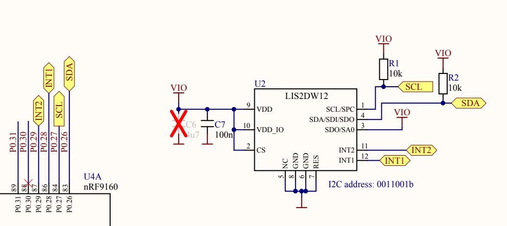

Do you have any ideas how to get the power consumption down? Is the schematics and all of the configurations okay or have we missed something?

the schematic seems ok to me, except for the 10 uF capacitor between Vdd and GND that you do not have (but it should not give a problem like this).

"the schematic seems ok to me, except for the 10 uF capacitor between Vdd and GND that you do not have (but it should not give a problem like this)."
What should we achieve by adding this capacitor?

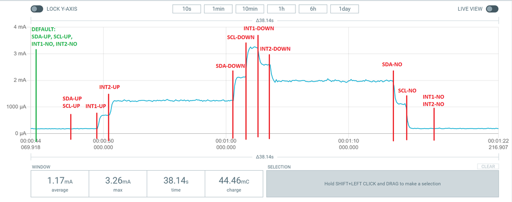

We tried changing the internal pull-ups of the GPIOs on nRF9160. Here you can see the results of the changes:

  • the capacitor should add noise filtering capability on Vdd, it is good practice to use the ones shown in the application hints

  •  on nRF9160 side these pull-ups can delay a little the signal but they should not be able to draw a lot of current
  • the default are the correct ones if you do not add some external hw that changes the situation. the fact that you tried different configuration in your latest message seems to be proof that they are right
  • when using I2C you should always keep CS pin high. an internal pull-up is the reason why disconnecting it does not break I2C communication immediately, but it is not correct to leave it disconnected
