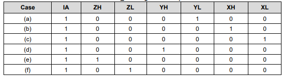

Hi @KYeo.1​ , the AN5005 (at p.28) is a little more detailed than the datasheet. Supposing you want to detect the e) or f) position of Figure 14, you have to set the INT1_SRC register according to the following table. If you then want to make the interrupt last about 3 seconds, you can set the INT1_DURATION (33h) register to N/ODR time, to get the appropriate timing (the value depends on the chosen ODR)

Thank you for the reply. I want to detect position E in Figure 14. I don't understand when you say I have to set the INT1_SRC register because this is a read only register. Do you mean setting the INT_CFG instead?

Yes, I was referring to INT_CFG register, sorry... so you want to generate an interrupt after the device is in flat position at least from 3 seconds, and not for a 3 second interval just after the device is in flat position... it si not so simple, I'm afraid... you could maybe latch the interrupt for 3 seconds (LIR_INT1 bit of CTRL_REG5 (24h), and setting the INT1_DURATION (33h) as before), and enable INT_POLARITY of CTRL_REG6 (25h) to have a transition from low to high when the event occurs... this procedure could however be affected by false positive events (for example changing the device position during the 3 seconds), but you should check if this is the case... Regards

The settings for the INT1_CFG register is also confusing. In the datasheet, it states that if AIO = 1 and 6D =1, this will set the interrupt mode to 6D position recognition. Meaning that the interrupt will remain HIGH as long as it is in a known zone. For me, this is not working. It only works if I set AIO = 0 and 6D = 1. Also, in AN5005, I follow table 19 and set ZH = 1 and the rest to 0 and this is not detecting the flat orientation. Instead when I set XL = 1 and the rest to 0, then I am able to detect the flat orientation.
Hi @KYeo.1​ , you are right, as per ST documentation the D[6:0] bits of the INT1_DURATION (33h) sets the minimum duration of the Interrupt 2 event to be recognized. Duration steps and maximum values depend on the ODR chosen. Duration time is measured in N/ODR, where N is the content of the duration register. As regards the AOI and 6D configuration, setting AOI = 10 and 6D = 0, you will detect the 6-direction movement recognition instead of the 6-direction position recognition... so the interrupts should generate after 3 seconds from the position change, ad I described above... but is your device in flat configuration (i.e. mounted and placed so that the X-Y plane is perpendicular to the floor)? Regards
