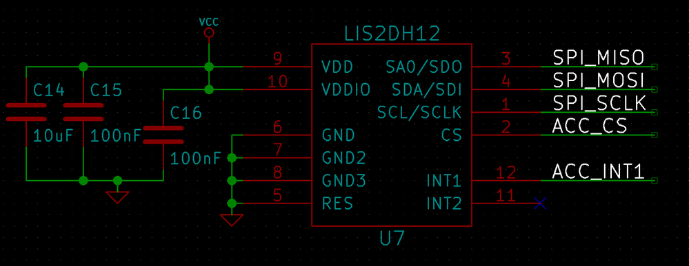

Posted on March 15, 2018 at 16:53
What bus are you using, I2C or SPI?
Are there any other devices connected to this bus?
Can you share you schematics and layout?
Posted on March 15, 2018 at 18:20
We're using SPI (MOSI/MISO/SCK/CS).
VCC is 2.8V
There is another device on the bus that is driven with another CS line.
Of course, we designed the code so they never ever talk together at the same time.

Posted on March 19, 2018 at 15:02
Are you using SPI mode 3 for the communication?
Posted on March 19, 2018 at 15:10
Yes I do (Clock idles at high, MOSI shifts on high-to-low, MISO reads on low-to-high)
Posted on March 27, 2018 at 14:01
After some tests, it seems that when I stop all comunications with the other SPI device (same bus), the LIS2DH12 stops enterring this weird state.
Perhaps there is something like data transmitted to the other device interpreted as I2C frames (CS = 1: SPI idle mode / I2C communication enabled). On top of that the SPI communication speed is way faster than the I2C max speed (4MHz).
Is it possible to somehow disable the I2C interface ?
