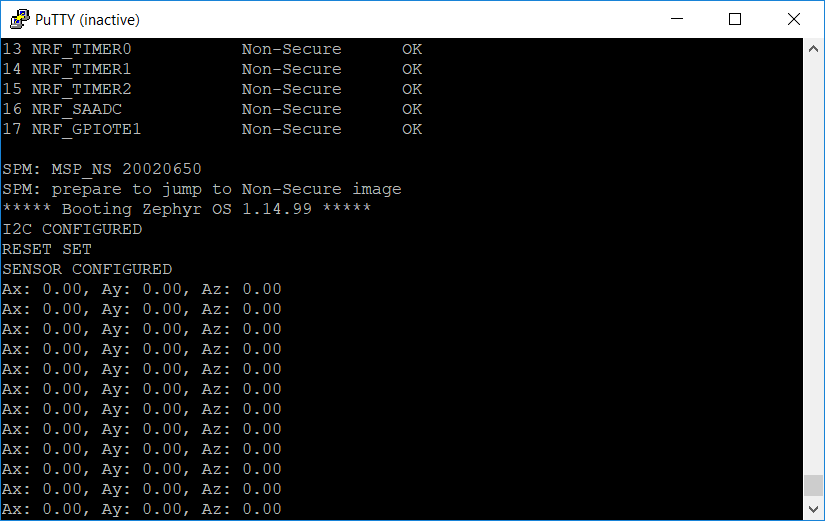

I am trying to interface the LSM6DSO (STEVAL-MKI196V1) sensor with nrf9160-DK using the code below.
I tried similar code for the BMI160 sensor and it is working fine with nRF9160-DK.
Moreover, I tried working on LSM6DSO sensor with P-Nucleo-WB55 board and it works fine.

If I comment the following part in the code,
lsm6dso_device_id_get(&dev_ctx, &whoamI);
  //if(whoamI != LSM6DSO_ID)
  //    while(1);
  //printf("DEVICE ID GET\r\n");
lsm6dso_reset_set(&dev_ctx, PROPERTY_ENABLE);
, the program proceeds to the next stage but only gives zeros.
Can you please guide me on this issue?
I think the problem is with the i2c read and write function. Am I initialising read and write function properly?

ASoni.2
Hello, Just solved this issue. I had to shift LSM6DSO_I2C_ADD_L to right by 1 bit.
