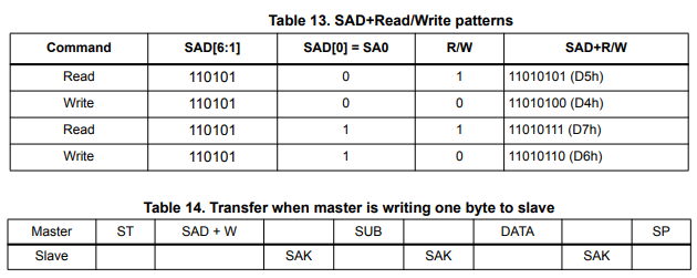

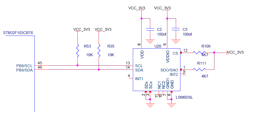

Hello everyone,
I'm looking for a basic timing diagram or procedural sequence of the LSM6DSL with I2C interface, which could explain me the working flow, reading and writing of register, I2C configurations, etc. At the moment, I just wanted to read the acceleration and angular movement. In future, I might want to implement the temperature sensing as well. Unfortunately, I'm not able to find any useful resources which guild me to complete my lower level initialization. Can anyone help me with a sample code, referential document (other than datasheet)? Also, does the temperature sensor gives the temperature reading of surrounding or the IC's temperature?
I've interface the LSM6DSL on STM32F103CBT6 (I2C1),
I'm using standard peripheral.
Since I2C is a standard communication protocol, there are a lot of complete descriptions in literature... I2C communication is also well described in the LSM6DSL datasheet p.38 and sgg

To understand in detail your problem, you should send us the oscilloscope I2C pattern...
